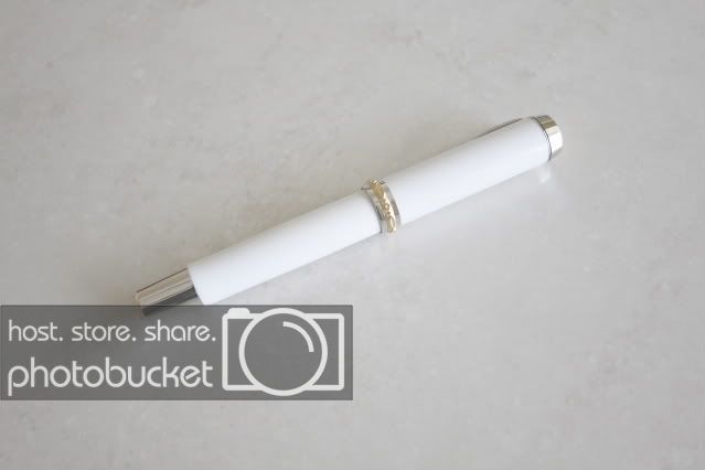

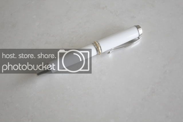

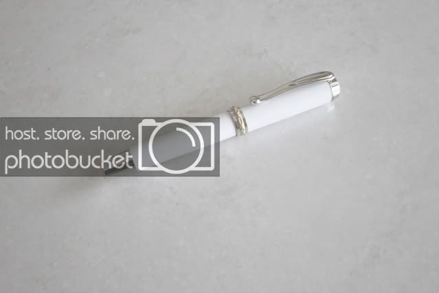

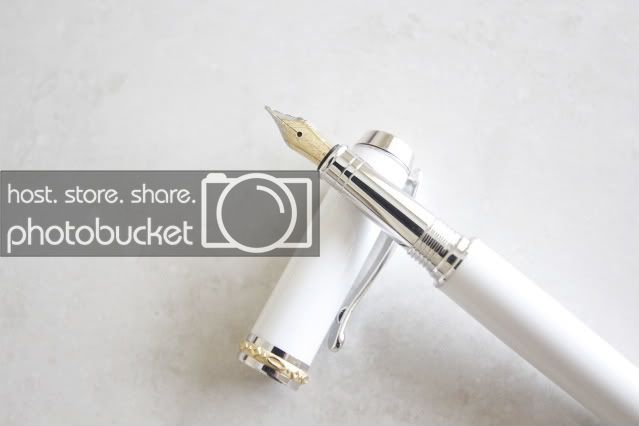

A Jnr Statesman in my own cast version of wedding white. Wet sanded to 12k MM the 2 stage buffed
The Jr. Statesman is very "elegant" for the occasion. With the "gold" trim around the center band, it makes it so right. I like your effort here.

Very classy, I like it. I haven't had good luck with casting white, at least getting one I liked. Did you cast it in PR or Alumilite?

I just used a clear casting resin available at out local Bunnings store, not sure exactly what type of resin it is. I used some Alumilite white colour and some white pearl pearlex powder. We only have the water clear Alumilite here and have not had any real success with it. The bottles arrived seal but in some cases have only 75% volume in them. The white dye onl had a small portion in the bottom, I think it it is very old stock as the packaging is also different to what I see you guys get.

It looks fantastic. I haven't a pressure pot so I really haven't jumped in to the casting pool, just waded apparently. From the pics it looks like you have a winning recipe.
