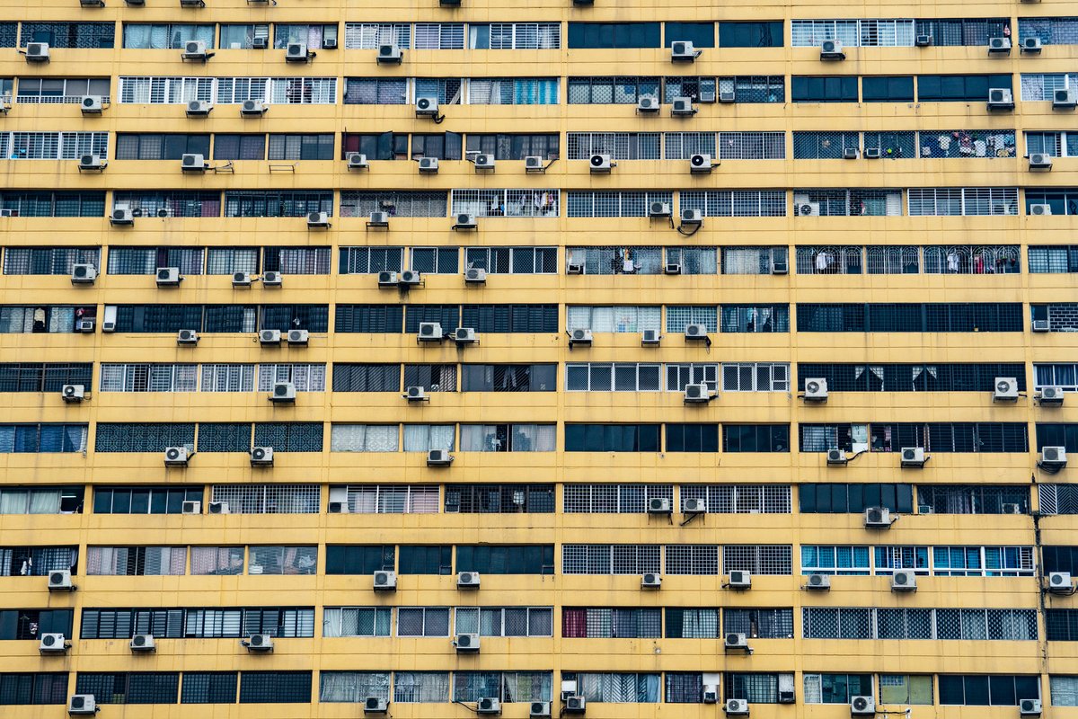

I came across this article yesterday which has a catchy title, and it might be of interest to some so I will give the URL.
I might need to stress that I am not being controversial in any way, just providing access to "information", if that's what it's about.
I should also stress that I haven't a clue about anything related to weather except the conversions between degrees F and degrees C.
So here's the article about AC with the catchy title ....
