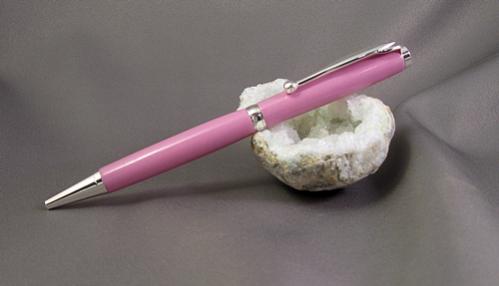

Pink! I want!
Anyway, I found the blue water pipe to be quite a bit softer than the typical acrylic blank. It also burns easily. So slow speeds, lots of water, and finish with Meguiar's PlastX plastic polish.

Pink it's actually purple but on the pink side. I have it here http://www.penturners.org/forum/showthread.php?t=37746
