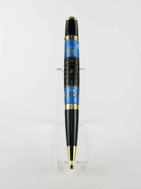

This is straight out of the camera, no color corrections/editing other than re-sizing.
Metallic Blue watch parts pen on a white paper background.
Comments / critiques on the photo?
How does the color look? It looks good on the camera and my monitor sucks so its hard to tell.

Hi Mike.
On my screen the black section is a bit dark. If I alter the angle of my screen (MacBook Pro) it does come in lighter and clearer.
As to the pen/cast... Looks mighty fine. The divisions in the sections are clear, and all looks like a good cast. The face is straight and clean.
Have Fun!
Huh.... the whole thing looks a lot darker on my phone. On the camera the background was a bright white and i couldnt see the bottom/back of the pen stand.
The pen stand is clearly visable. And the picture is pretty good - just helping you to tweak it!
Can it be cropped to bring the picture in closer?

I like it very much just the way it is ... beautiful pen !!! The blue seems to be Royal Blue!
Hello Mike
I know you mentioned you would like critique on the photo. It looks fine once you enlarge it. Click on the thumbnail and then click the photo and it looks good.
Now if you don't mind a comment on the blank itself. Ignore if you prefer. Not sure if this is your first and you are just starting on these but It needs gold colored hands to break up the face. I hate watch part pens without hands on the face. If you are not going to put them on the face then put them in the blank somehow. Never do you see a watch sold without hands and that goes for high priced watches. yes you have to choose them but they do come with every watch out there.
Another point. If doing a sierra blank, leave the small parts out if you are using a large face like that. Just use gears and fill them in doing a pattern of some sort. Those little brackets and screws are not for a pen like that. You use them on a 2 piece pen where you fill the blank up. Your blank the parts are too spread out and sparse.
I like the color background. It breaks up the parts well and is a change from carbon fiber that is overplayed already.
Now these are constructive points but as I said you can ignore them completely and forgive me for posting them. meant no harm by them. Just trying to help you take this to the next level. have fun.:smile:

I photo shopped your photo, I hope you don't mind.
I zoomed it in allot and other normal photo chop stuff.
Personally I think your slightly out of focus.
Because you cannot manually focus your camera, you have a couple choices.
If you are using a tripod to could tether your camera to your lap top
so you can zoom the picture in so you can get the sharpest photo possible.
your Lap top can zoom in then just move the pen toward the camera or away from the camera to fine tune your focus.
Or use live view and zoom in with the button that zooms in in the screen of your camera and then move the camera toward or away from the pen.
Because your camera has fixed focus positions its very easy to have your cameras focal length in between one focus setting to the next focus setting.
I agree that the camera appears to have focused on the nosecone, or even the front of the stand. It isn't bad overall, but it would have been better to focus closer to the middle of the pen.

The Canon Powershot G15 does have manual focus. The process, however, is rather cumbersome. It's very simple, however, to focus on the desired spot by holding the shutter release button partway down, then recompose, and shoot. The G15 will draw a box around the point of focus when press the shutter release button partway down, so you can easily tell where the camera is focusing.

Your focus problem is from the way the pen stand is oriented to the camera. The top of the pen is tilted away from the lens. If you turn the stand and shoot from the side, you'll fix that, but part of the pen will be obsured by the stand. I was told years ago to eliminate the stand. Which I did. Just my little piece of input.

Maybe, but doubtful. The photo was shot with a shutter speed of 1/170 sec at a focal length of 18mm. That should be plenty fast enough to prevent camera shake (especially with image stabilization on). The aperture of f/4 and a distance of roughly 1.5ft yields a depth-of-field of about 1.3 inches, which is visible in the photo - The nosecone (and the front edge of the stand) is sharp, but the finial is slightly blurred. Focusing closer to the centerband would help, as would a smaller aperture. F/5.6 would yield a DoF of about 1.8 in and f/8 would extend that to 2.6 in. A 35mm camera (such as the 5D series) using an 85mm lens at f/22 would produce roughly the same field-of-view and depth-of-field as the G15 at f/4. A 5D at f/32 would yield similar DoF as the G15 at f/5.6.
I suspect that the overall softness is more likely due to the algorithm used to resize the image. The IAP "upload manager" automatic resize (last I checked) softens photos quite a bit. If you are resizing images before uploading (which I highly recommend), and have a choice of algorithms, try "bicubic sharper", and you may want to sharpen the image again (try "unsharp mask") before saving.
