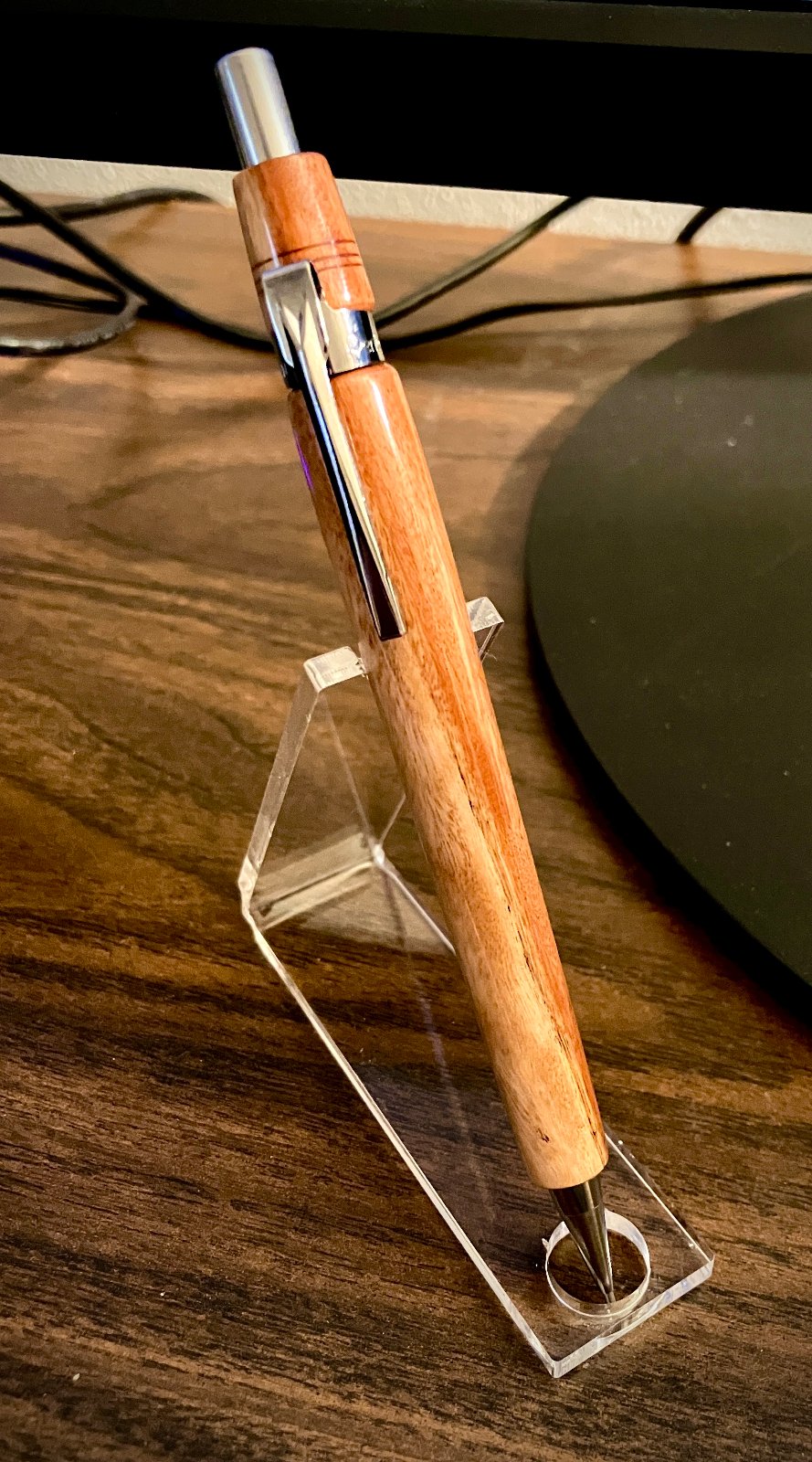

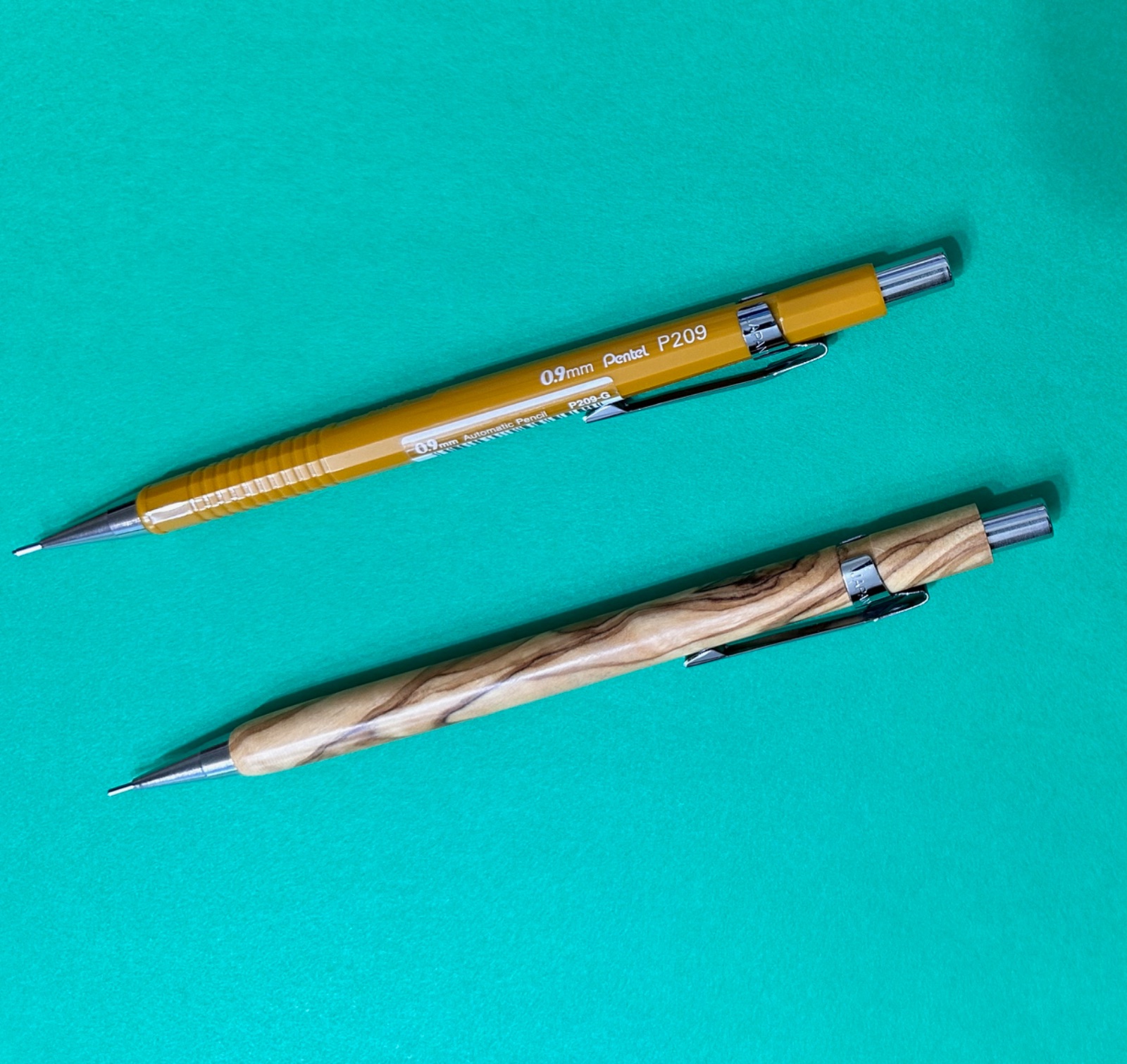

So when you got little extra time waiting glue to set for project and looking for simple project. Just busted out a new dress for Pentel 0.9mm pencil.
Grabbed chunk of Olive wood for this project. Really. fun turning to make.

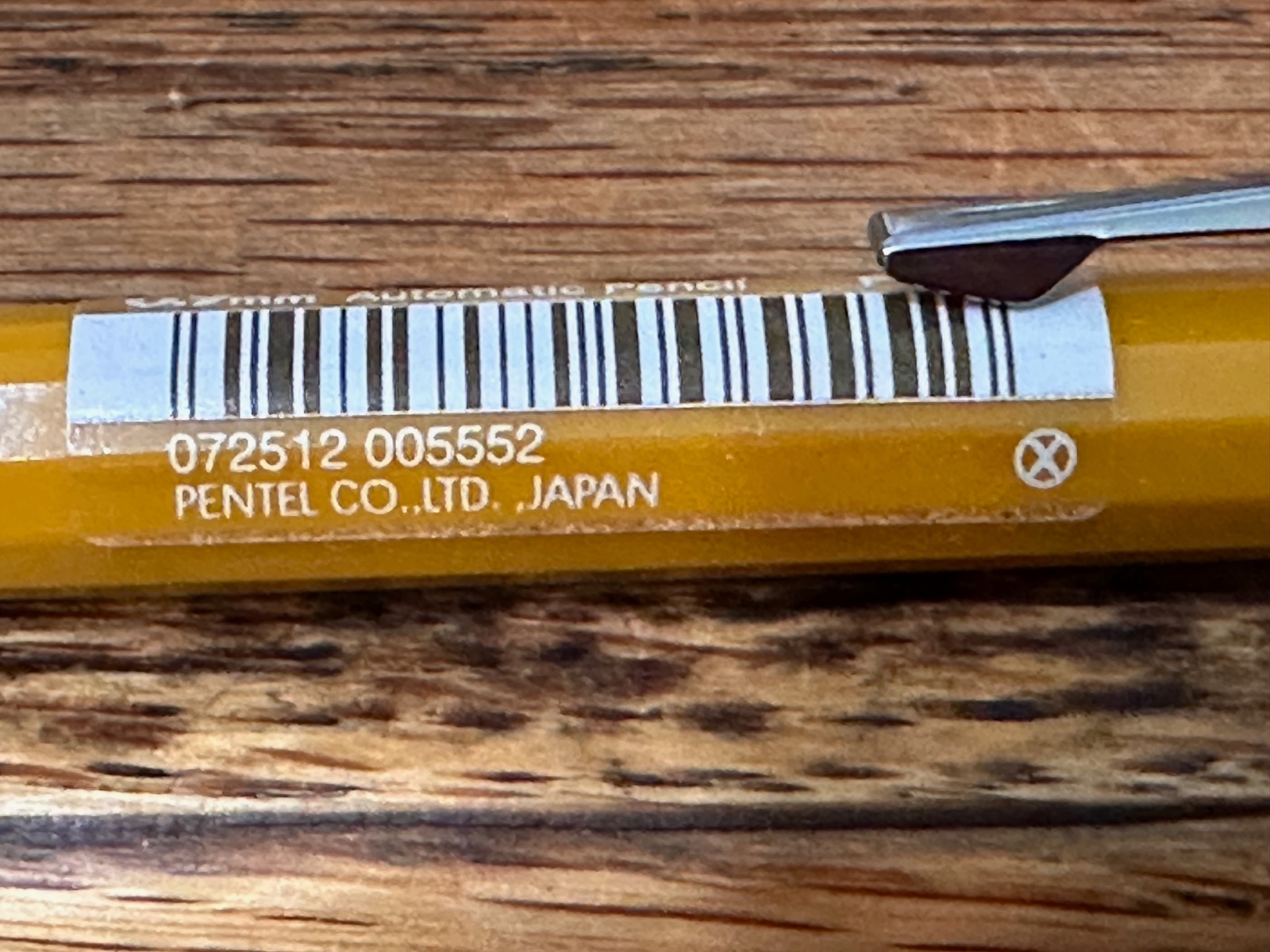

Part number for 9mm 209 Pentel is photo attached . I just bought a pair a Office Max yesterday.
I just check Amazon and the have m lot of 9
mm pencil plus the Pentel P209 9mm like the one I got and show in photo.
