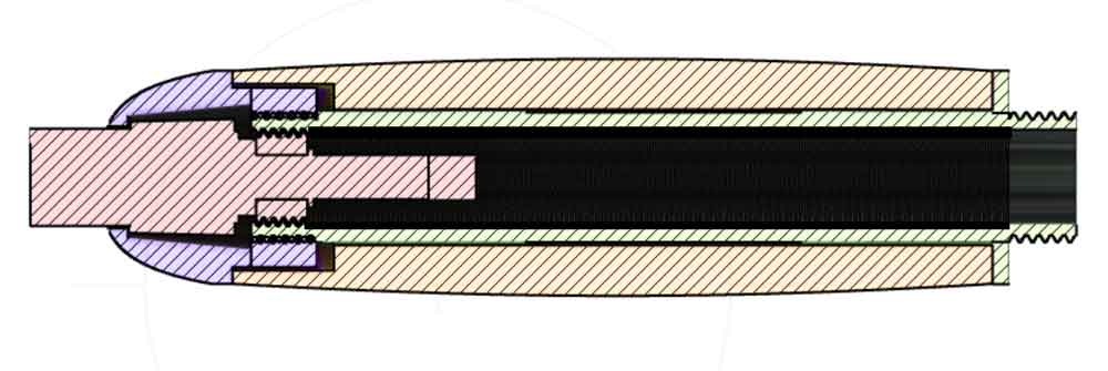

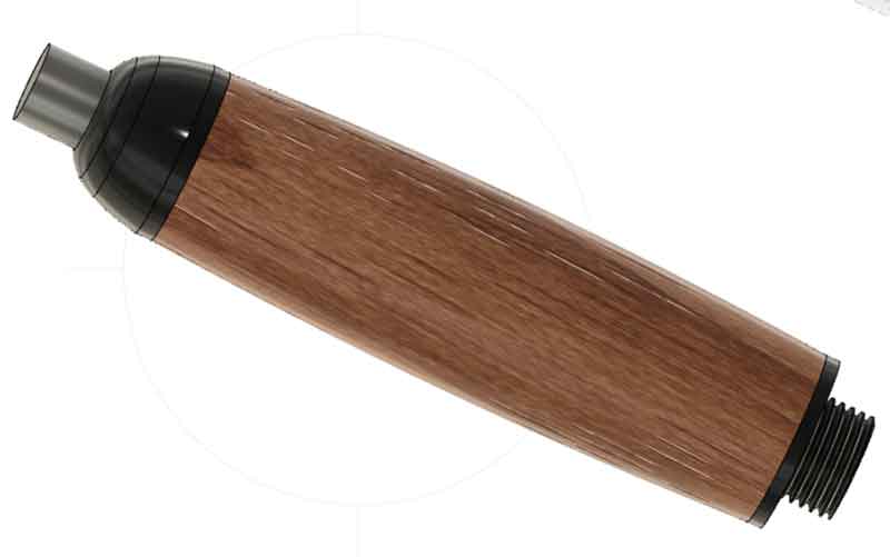

@magpens and I have talked a few times about how concealing some of the lower tier would help the look of the mechanism atop a pen. So I got to thinking about how you could encase the whole lower mechanism. I've been also anyway that a way to combat the spindly appearance (eye of the beholder, i know...) of these long body clickers would to have a decorative center band to break up the length. To assemble the pen, you first glue a "clicker tomb dome" onto the top. Then you screw the SKM88 onto the top of an insert "tube" that you then insert into the bottom of the upper body. The insert tube threads into the dome you glued in place. That insert tube provides the center decorative center band and could be glued or threaded into the lower body.
It would be a fat pen - I measured this design to be 0.7" at the center girth of the wood on the upper body.
Here's a couple of pics (I'm just showing the upper body):

I think that 0.7" is too fat. . I am not quite understanding the text description above. . And in the diagram, it is not clear to me if there are threads between the light green portion and the light purple portion; ... if so, that might be the cause of the excessive thickness.

Yes, i was thinking threads between the green and blue/purple, so the top of that green "insert tube" has inner threads for the SKM and outer threads to mate with the dome. With those four layers in that one point (SKM + "insert tube" + dome + body)... yes, I think that's driving the thickness.
I remember your wooden cap, but was thinking that it was just a visual mock up... was it functional (e.g. some way of affixing it)? I guess you could just glue it in place, though I was thinking I'd want to be able to preserve the ability to remove the clicker.
Using the colors as reference... the purple part (dome) is glued to the yellow part(wood). The pink SKM is screwed into the green insert tube. The SKM/insert tube assembly is then inserted into the yellow body (from below) and screws into the purple dome.
