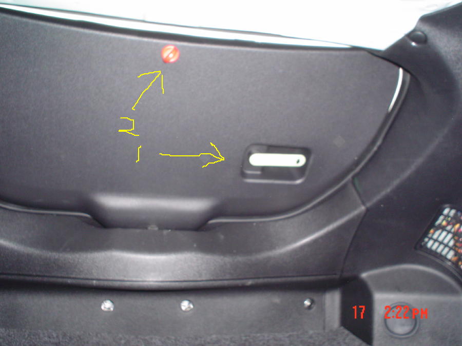

Any one know how to manually open the Trunk on the VW New Beetle (Model Year 2010 - Convertible) Neither the switch key button or the door button will work - on the switch key the lights blink as if it worked but it doesn't. The door does nothing. Everything else works. I know there is some sort of a manual way to open it but don't know what it is.
Look in and around or under the rear seat there is probably a release cable and handle possibly red or yellow. may have to remove rear seat bottom cousin.
Item 1 is the lever or handle to open trunk and item 2 is the plug to remove and pull to open on some models.
Smitty this might work but not sure on a convertible, reach in through the little access door in back seat if it has one, pull the manual trunk release
I tried that but it doesn't seem to be working. I thought maybe you have to do something else as well.
