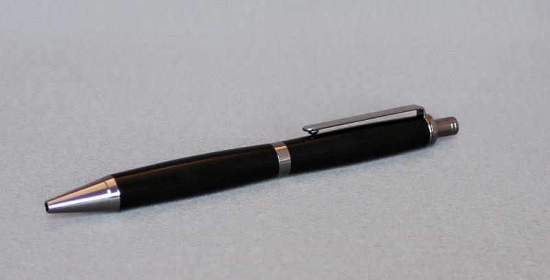

Shown here with a slimline pro black Ti kit.
