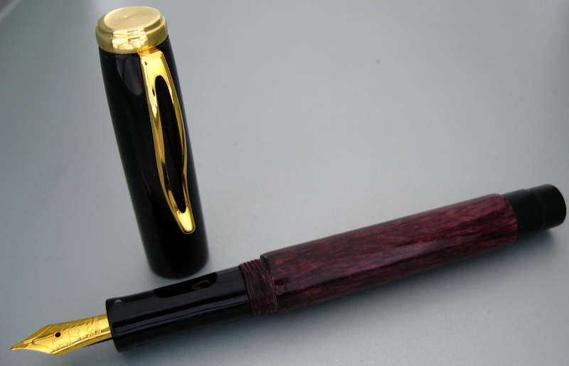

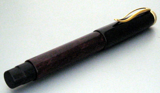

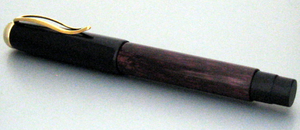

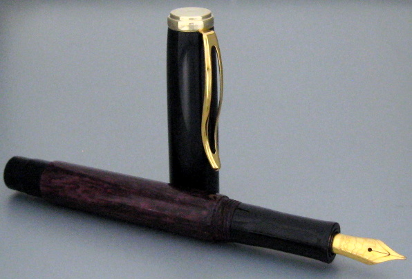

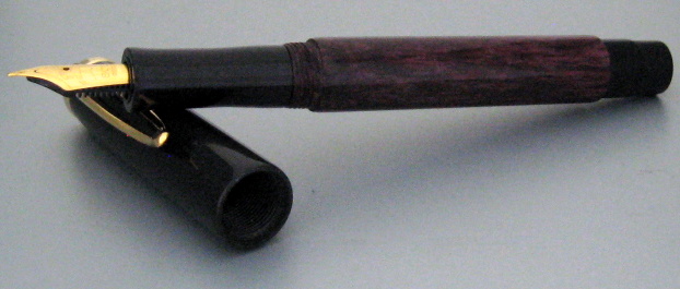

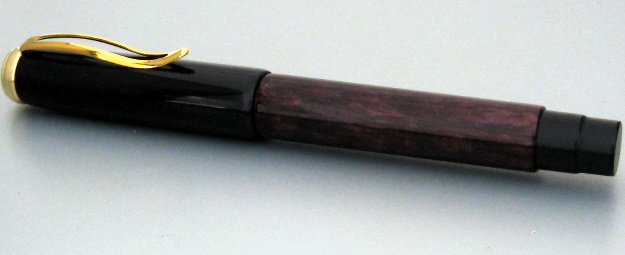

George (texatdurango) sent these blanks, probably two months ago.:redface: Thank you George. Finally got around to turning them into some semblance of a pen. #5 Bock nib. Custom brass finial, and decided to fore go the bands on this one. I think there should be one at the bottom of the cap. The barrel finial is ebonite. I still struggle with polishing this stuff. Even following directions from friends. Need a little more practice with it. Expensive learning curve though. Any advise on the photos suddenly appearing grainy? Thanks all, for comments, and for looking.
My first guess is your camera was set on automatic settings and switched to a higher ISO setting (as evidence by the post below your original one). If you changed to a higher f-number to get a smaller aperture (which provides more depth of field), the camera has to adjust by increasing the shutter speed or the ISO setting, or both. And it looks like you may have been photographing under low levels of light which would have caused the camera to compensate even more.
This is generally why some photographers prefer using manual settings. That way the ISO can be set to the desired value, The aperture set to gain the DOF wanted, and the shutter speed allowed to go slower to accommodate the lighting. Usually a tripod is needed due to shutter speed being very slow to keep the other settings where we want them. I hope this helps!
Very nice Chuck. I agree with you in that I think it needs a band or two.
Thanks Derek. It doesn't hurt to try different looks, I suppose.
Thanks Dave, I admit, I've been avoiding the manual settings, and sticking with the auto button. I'll spend some time getting the right settings. Very much appreciated.

ISO around 800? :eek: Second set much better.

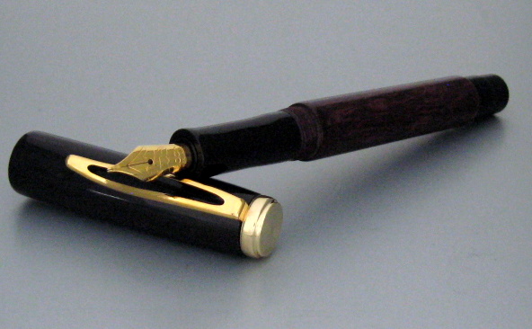

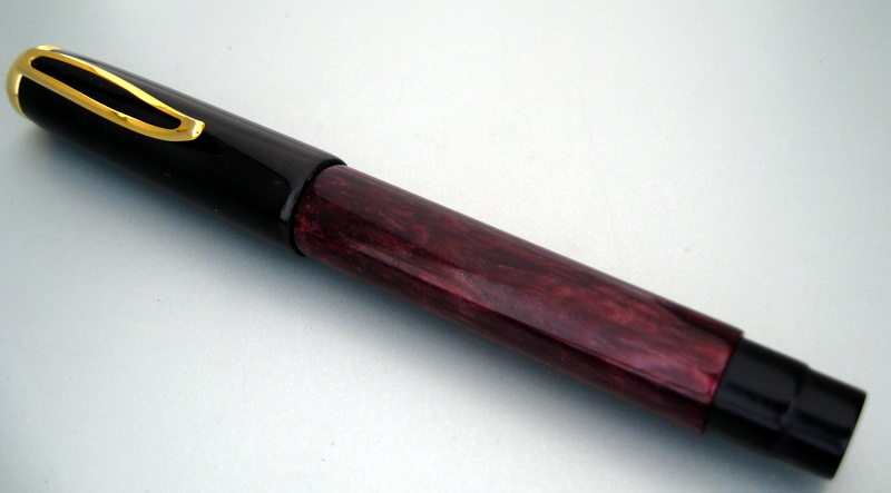

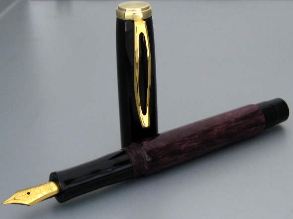

I just couldn't let this pen go with those lousy photos. George would be disappointed to say the least. So, I spent some time learning about my camera (Canon A560), and got some photos, that are a LITTLE better.

I did some quick reading, and found the ISO setting got switched to HIGH. These are a little better.
That was going to be my suggestion. With digital, it is referred to as "noise" which are artifacts that appear as "film grain" !:biggrin: Standard recommendation, assuming you have enough light, is to shoot at around 80 to 200 ISO. Anyway, uze got it figgered out an dats all dat matterz! :biggrin::biggrin::biggrin:
