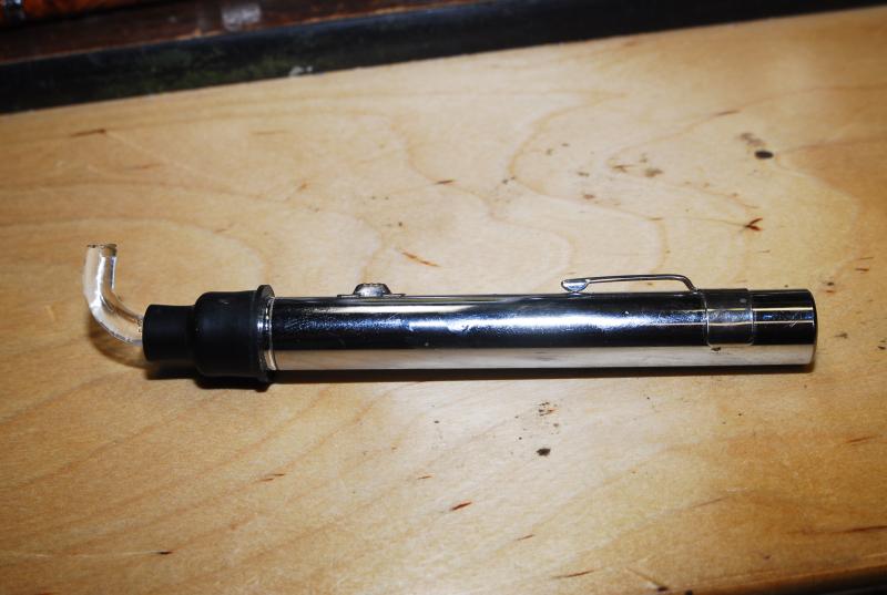

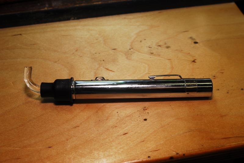

Dave: Yep, good video! Another way of viewing the inside of your tubes to check for glue or any other deformity is with a gunsmith bore light. This is a double A battery flashlight with a curved piece of acrylic rod that directs the light down the bore of a rifle, pistol, OR (how bout this) a pen tube. I can't seem to get the pic to upload, I'll go ahead and send this and then check Jeffs' videos on how to insert an image and try to send a pic of the device of which I speak. They are inexpensive and pay great dividends.
