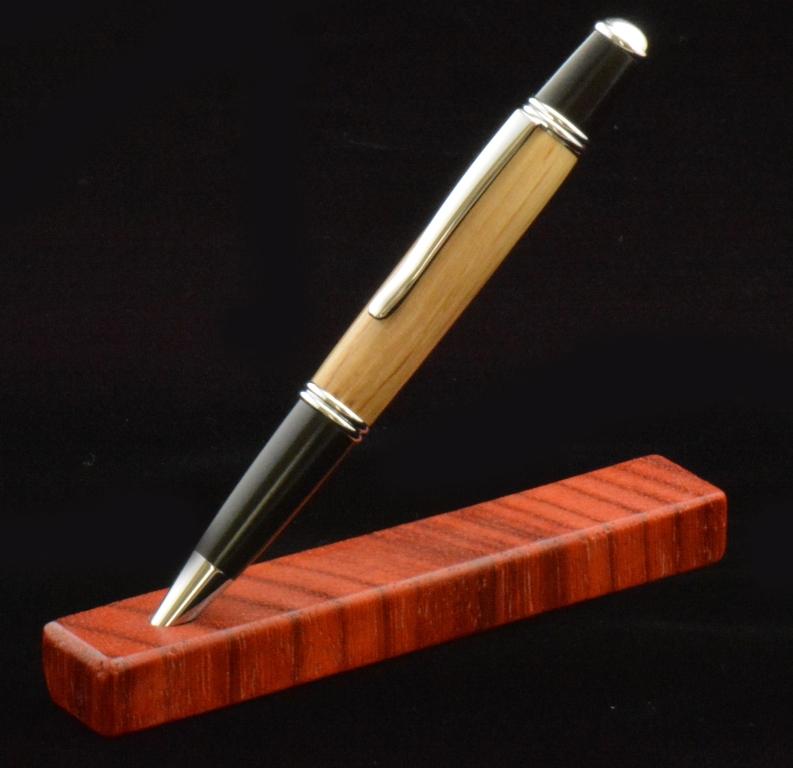

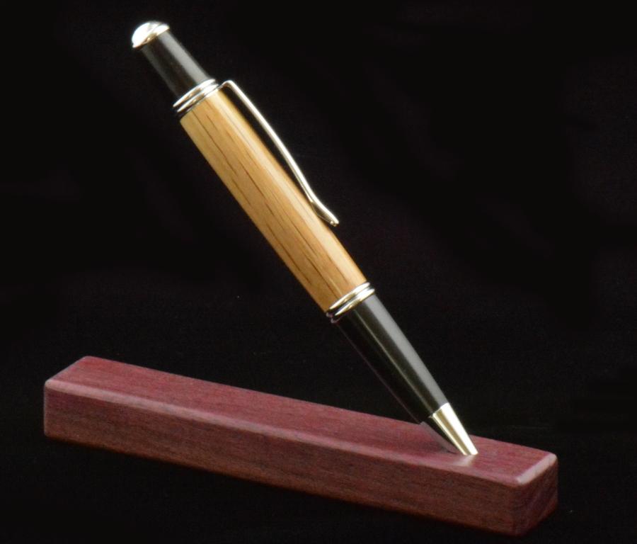

I have had several requests for inexpensive but functional pen stands and this is what I came up with. It's definitely not my design I saw it at a local Woodcraft and just kept it in my memory bank. Theirs was an unfinished pen blank that did not work for me so some finishing was needed. People who buy a $25-$35 pen are not interested in spending $50 for an elegant pen stand, but they might spend $10. I just delivered a dozen assorted stands to the GallerynGifts store using walnut, maple, red cedar, Padauk, purpleheart and bloodwood. Some are 3/4"x3/4"x5" and others like these are from smaller cutoffs.

The angle is 45 degrees and the bit is a 60 degree sign making router bit that was easy to use in my drill press. I bought it from either Woodcraft or Rockler. I used clamps and stopblocks to get the centering and distance right and made a bunch. They work up to bolt action so Saturn/comfort/Roadster, Sierra and bolt action. I will make a wider version with a larger hole for steampunk soon. I will post it.

I don't have anything to measure angles, but I measured the tip of a Sierra with my calipers and did the math. Unless I did something terribly wrong, it looks like the tip angle is about 15 degrees. I'm guessing the 60 degrees is a typo - it looks like the bit in the pic you posted is a 15 degree, which matches my math. I'm definitely going to try this, but gonna have to buy a bit first (sadly I don't have a CNC, and therefore don't have random spare CNC bits...).
