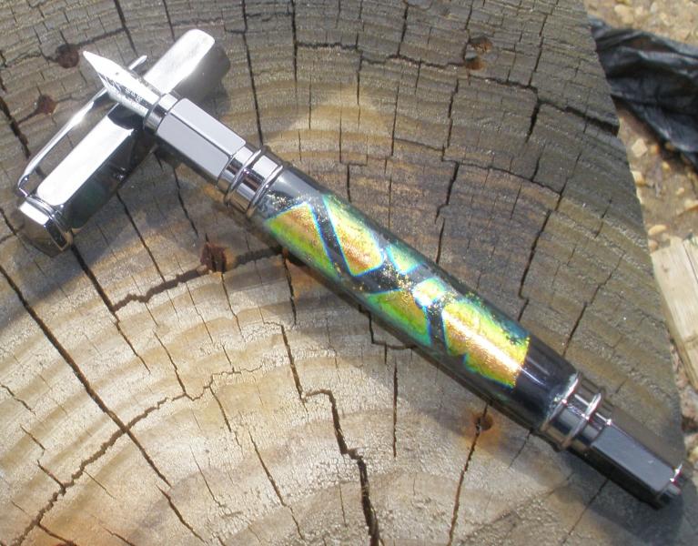

Okay, so I got a couple of these to try out. I wanted to see how they really looked and felt and to get an idea on the quality of the plating in terms of wear (So I will have to come back in and report on the wear later). This will be my daily writer for a while, so expect more thoughts later, but here are the inital reactions.
the facts: This is a magnetic cap Fountain pen (also available as a rollerball) with a hexagonal finial, section and cap. Very simple in design and about the same skill level as the ever popular Sierra family since it's a single tube.
In fact I'd say its even easier than the sierra as the couplers that are pressed into the tube have a ringed design that isn't meant to be a flush fit. The rings are meant to stand proud of the blank material slightly as they are rounded. Both ends are the same diameter, so again very easy on the turning side of the equation.
The cap: is noticeably smaller in diameter than the cap of the Stretch Fountain which is based on the Jr. Series of Dayacom pens. It isn't ornamented at all (a plus in my book) and has a very tight clip. The clip actually tore the single sheet of paper that I clipped it on after a meeting earlier when I removed it. The inside edge of the cap does seem to have some irregularities in the plating. It was a very tight (almost like a snap top pen) fit at first. This is getting better as the top is removed and replaced but concerns me about plating wear on the mating surface of the coupler.
The cap's magnet actually doesn't activate on the traditional coupler component of the set, but instead activates on the portion of the section closest to the nib, and on the top most portion of the finial. Just an observation as I don't know if that is potentially good or bad.
Pen is comfortable in my hand either unposted or posted, but my hands aren't overly large. I may give one to a friend whose hands are gargantuan compare to mine (not exactly small either) for his thoughts.
Not that it's important, but in the half day I've been using it with the stock nib and stock ink (I know, how dare I) it is writing well if a bit on the wet side for my taste. I'm sure the nib is supposed to be a medium, but feels more like a broad to me. I may switch to one of Lou's semi-flex nibs and some good ink later.
So my initial reactions are pretty good.

What kind of blank is that?
You can see more pics of that pen if you find the thread "Dichroic v2.1"
The blank is Dichroic glass under resin that I made. Dawn was the one that originated the idea, and I'm trying to take it to the next level. The pics, they do it no justice.
I can vouch for that, I've seen Dawn's mark 1 dichroic blanks in person, a photo can't capture 1/10 of the color and movement.
