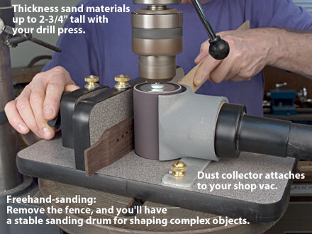

I use a drum sander, but probably not the type you are thinking of.
I have a sanding drum (like you could put on your drill press.) These don't cost much so don't count it out just cause you don't have one.
Using a piece of stock clamped like a fence next to the drum you can thickness sand the 1"x12"x?" strip to whatever thickness is needed for the job at hand.
Kirk - So you mean it would be set up like one of them oscillating spindle sanders? I have seen the tubes you can put on the drill press for those. I like your idea and think it would fit my application a bit. I may have to try that out.
Woody,
Yes except mine is not an oscillating sander.
Just made a "fence by screwing 2 pieces of 1x2 together at a right angle (edge to edge). That is clamped onto the sander and can move as little as needed to get the correct dimension.
If you need more info on this feel free to PM me.
