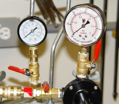

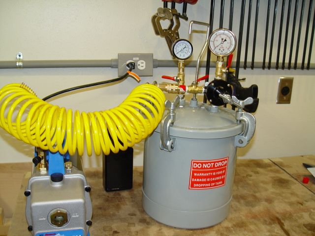

OK folks, here is my set up. HF pressure pot with a robinair 6 CFM pump. :D Thanks to all on the casting forum, I got plenty of ideas and set-up examples from there. While putting this tigether I learned "Flair", NIP and MIP are and how the threads are different etc. [:I] Anyway, I tested it on vacuume and almost made it to 30" of vacuume (see pic) it held at the same vacuume for 24 hours so I guess it seals well. The pressure though, I tested it up to 80 PSI (the pressure pot max) and within 4 hours it went to 70 PSI and held for a while. At the 24 hour mark it was down to 60 PSI...so something is leaking. Overall I am pretty satisfied, now once I pay Gadgett for the molds and get them I am all set.[:p]
If it seals on vacuum and not on pressure I would check the lid seal and any gauges/fittings that are not on the vacuum side of the house.
Looks really good!

Level of seal between 80 psi pressure and 30" vacuum is not even close to same affect on seal. Basically 30.00" or true vacuum is only -14.70 psi. So your leak test really test your system almost 15 psi in one direction and then 80 psi in the other. I think I got that right [:D]

You are doing much better than I am. On my HF pot the pressure relief valve pops at 40 psi. I have "fixed it" to obtain more pressure, but the seal starts leaking at about 45 psi. The seal looks to be in good shape but I can't seen to make it hold. It leaks down completely in an hour or so.
Oh yah, to find the leak use the "gas company" test. Get a squirt bottle and fill it up with a soap and water mix then squirt all your joints when the system is under pressure. Any leakes will blow bubbles for you.
