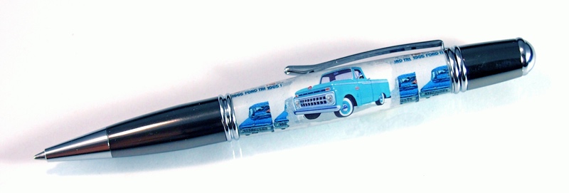

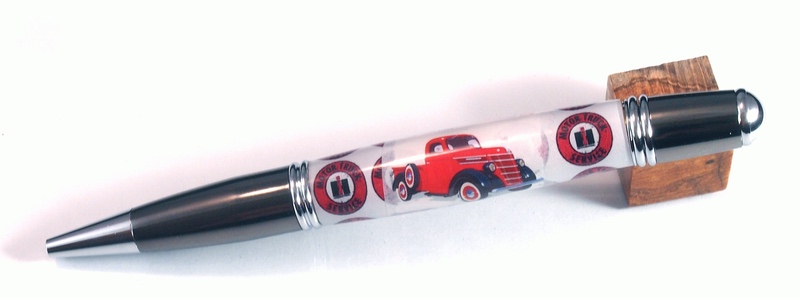

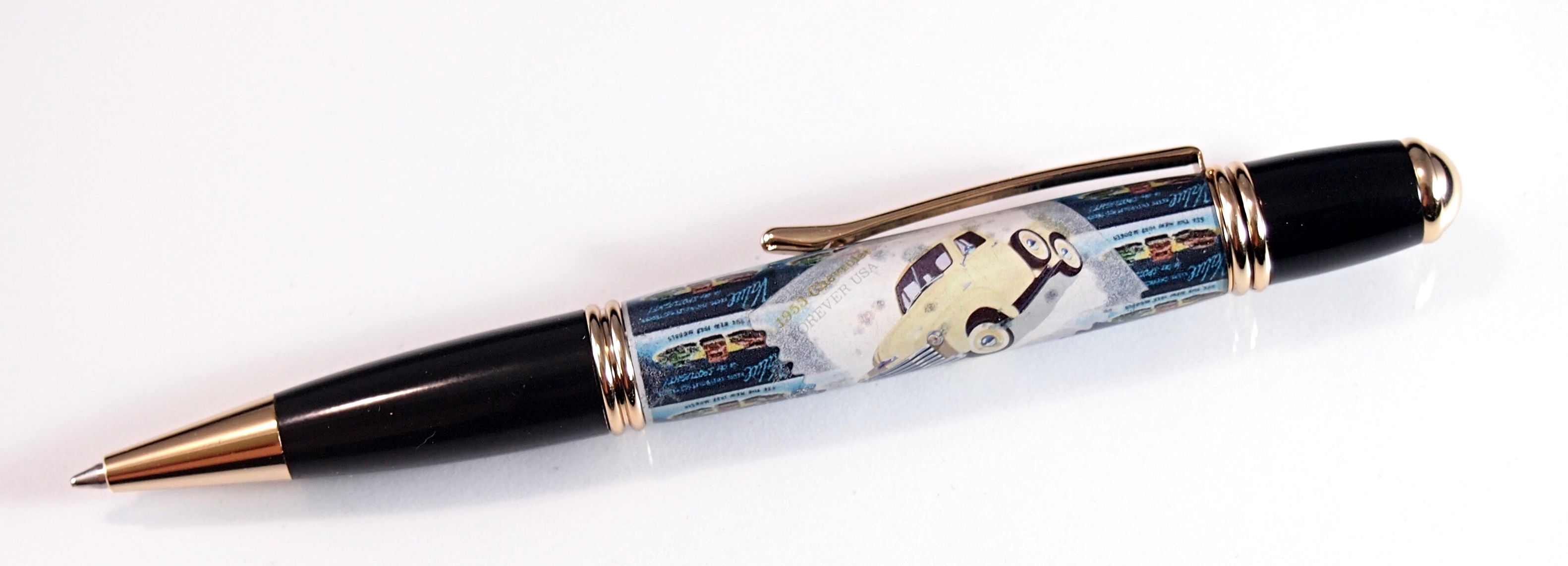

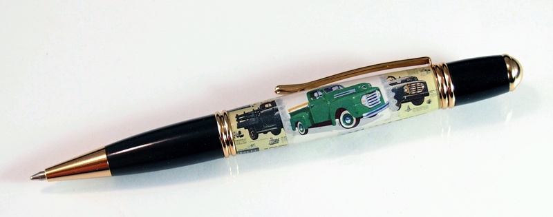

I finished up my truck stamp series today after having a go round with an airline. Turned the last one to vent my frustration. These stamps get transparent around the edges and the Chevy developed some mysterious spots, I might have to redo that one.
1938 International Harvester
View in Gallery
1948 Ford F-1
View in Gallery
1965 Ford F-100
View in Gallery
1953 Chevrolet
View in Gallery
I have cast a number of blanks from these stamps without issue. <knock on wood> The transparency around the edges looks like resin may be getting behind the stamp and permeating the paper. I seal mine with a light and quick coat or two of CA to prevent that.
The spots on the Chevy could also be resin getting into the paper. I normally only see that when casting used stamps taken off paper, where the structure of the stamp has been compromised in the removal process. I haven't seen everything, by any means.

I also think it could be the opacity of the edges of the stamps, being affected by the Resin.
Have you used any sealer on the Stamps?
As said previously, I Love your Stamp Work.
It is strange that this should occur now, it's is not like Stamps on Pens, are something new for you.
I'd be interested to hear what you resolve to be the cause.
