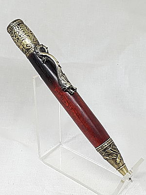

I've taken a torch to bloodwood and all it does is turn it black, which can be a good thing.
