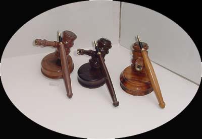

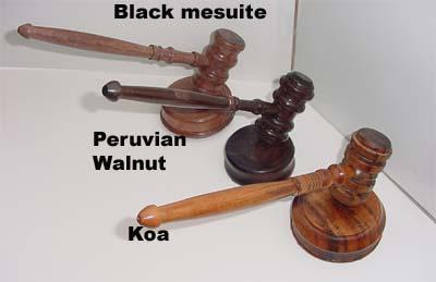

Don a/k/a It's Virgil: Thanks for posting those picture of your gavel/pen desk sets. I have been planning on making a couple gavel presentation sets but will change my concept. I will plagarize [:I], uh...er.. borrow your idea,if you don't mind. That is a very innovative concept.

don't mind at all...contact me if you have any questions about which kit I used or techniques. Maybe an article would be good to do and put in the archives.

A couple of other gavel/pens can be seen at http://www.tinyurl.com/38hor

Thanks, Don. Yes, an article would be great. Your pictures seem to show a pen style other than the desk kits we see for sale. Do you adapt something else. By the way, it is said that plagarizm is the sincerest form of flattery. [:p]

Thanks for the comments. The kits I use are the Euro screw cap FP/RB and the executive FP/RB. Keeping the handle parts concentric is my major problem. If using the euro screwcap, I reduced the diameter of the CB and conceal it inside the handle part where the bead/cove/decorations are. It is time consuming but produces a nice reslult. I went to a trophy shop and bought a cheap gavel and take the measurements from it. Contact me if I can help and you start the project before I do the article...I'm trying to get an article written on how I do my cartridge pens.
