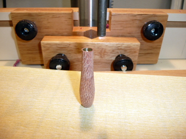

I love cool jigs and fixtures, but my shop is full and my bank account isn't and I needed a dead-on accurate way to square the ends of blanks after turning and finishing. This is what works for me.

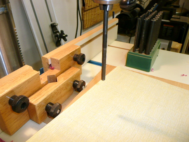

The basic setup is simply the drill press, a set of transfer punches, a small piece of smooth plywood (mine is a 12" square of baltic birch), and assorted sandpaper. I don't glue the sandpaper down, because I shift it around a lot as I work. Clean sandpaper cuts much faster.

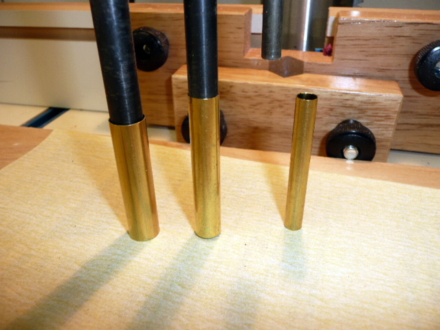

Find the right size punch for the tube you are using, and chuck it with the point up. This will keep the plywood from getting wrecked. Adjust the drill press so that there is enough gap to get the workpieces in and out, and for the punch to make firm contact with the sandpaper.
Please note that this is strictly a non-powered operation. The drill press is just a guide.

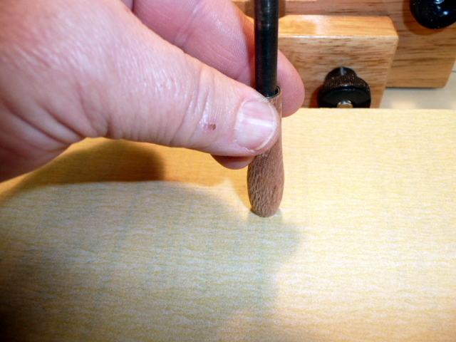

Place the workpiece on the punch, lower it down to the sandpaper, and twirl it back and forth a couple of times. That's usually all it takes.
Norton 3X 220 cuts fast and clean, but delicate woods require finer grits. If you're trying to do unturned blanks, get some 100 grit and pack a lunch. It will take a while!

Like I said, this is what works for me. I would just as soon put sharp things out of reach of my fingers. A slim transmission got the top of my thumb in the last pic, and I don't want them conspiring with the drill bits to get me in some other way. ;)

I make sleeves for all the tubes larger than 7mm. The sleeve is just a 7mm tube cut from 12" lengths.

I use a trimmer shaft that is a few sizes under the tubing size I am doing. I keep it perpendicular by pushing the tube up against the shaft on one side which is all that is needed. This allows the sandpaper to last significantly longer since you are using a much bigger surface of the paper than if you use the exact size shaft for your tubing. Works great for me. Some sandpapers last much longer than others doing this. I find a medium speed works best and usually just use a cheap 150 grit paper which seems to hold up rather well.
