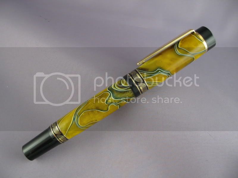

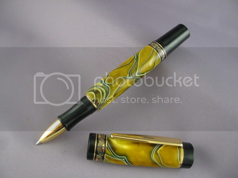

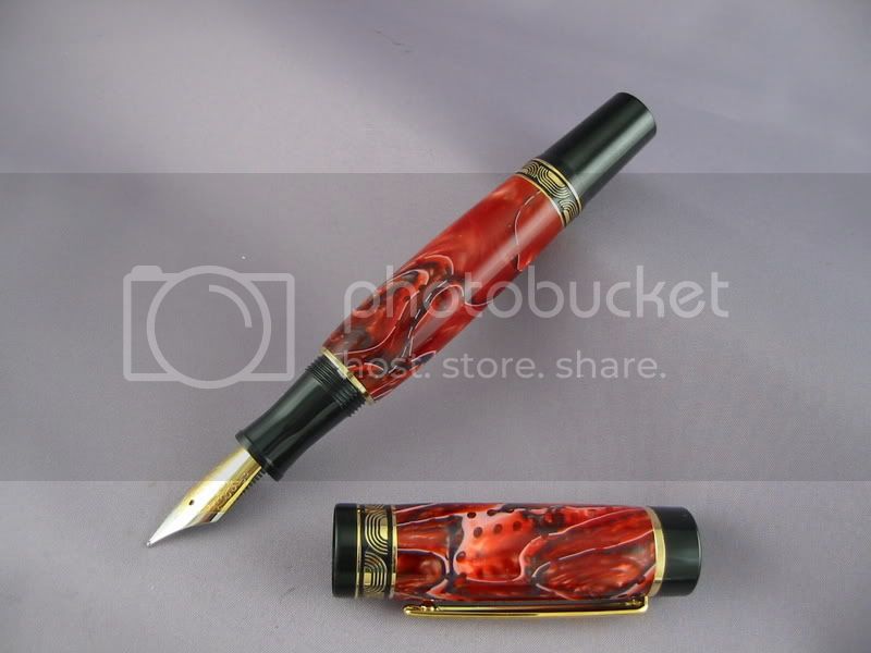

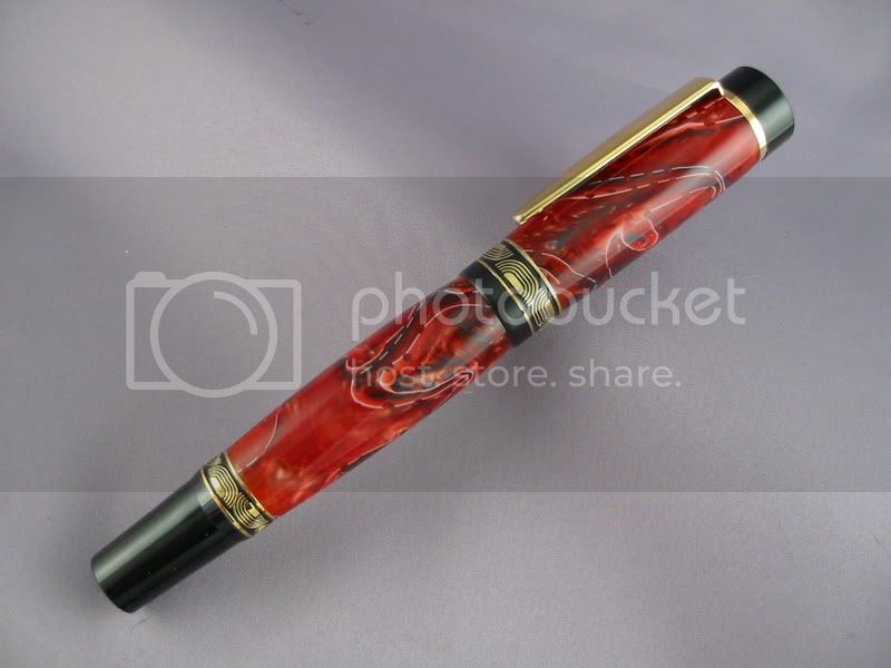

Well I have long been using Micro mesh and wet sanding for my finishes on plastics and stabilized woods.
Recently I watched a DVD on solid end pens by Ed Davidson (Yoyo Spin). In his DVD Ed sands his pens (320-400-600), then buffs them on his Beall using tripoli and white diamond.
I had to try it, I turned these two pens today using the same method Ed used..
Red celluloid from CSUSA
Gold celluloid from CSUSA
I think I have found a faster method to finish my pens that produces great results...
I am sure others out there do this too....I was a bit doubtful at first to be honest, but this worked out great:)

Finishes look good, not real glossy but a nice "satin" look (could be the photos).

They actually are very glossy...I am not sure why my pictures knocked it down, I have the lights in a new position...I like the idea of going to 3600 MM and see what happens...

yep i am sure its the photo, mine are mirror finish. i saw that same vid and tried it...thats the way for me too... i have a psi buffing system, not the beal. however, i tossed the crappy tripoli that came with the wheel and ordered the real stuff from silo. Works great on stabilized woods also with a coat of sanding sealer...watch ed's other video...
