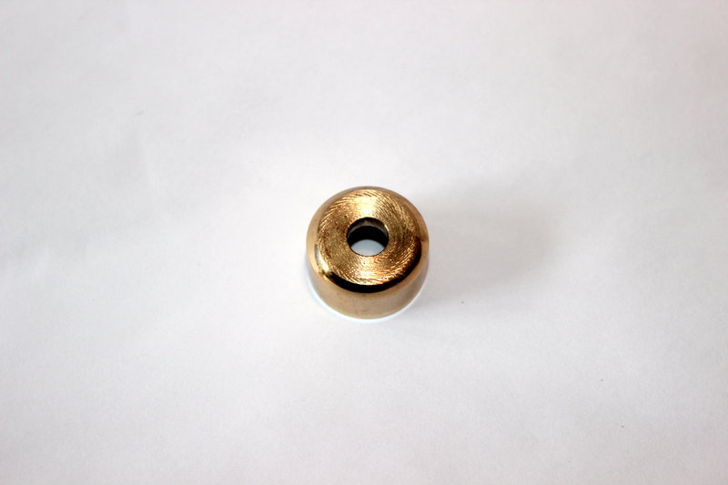

Coupler cap was drilled for tube and installed on upper body. Assembly was chucked up and the lower coupler was milled flat to mate with the lower section.

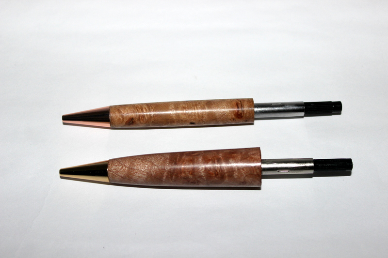

Here is the lower section next to a standard Euro section. Note the slight shortening of the cross refill.

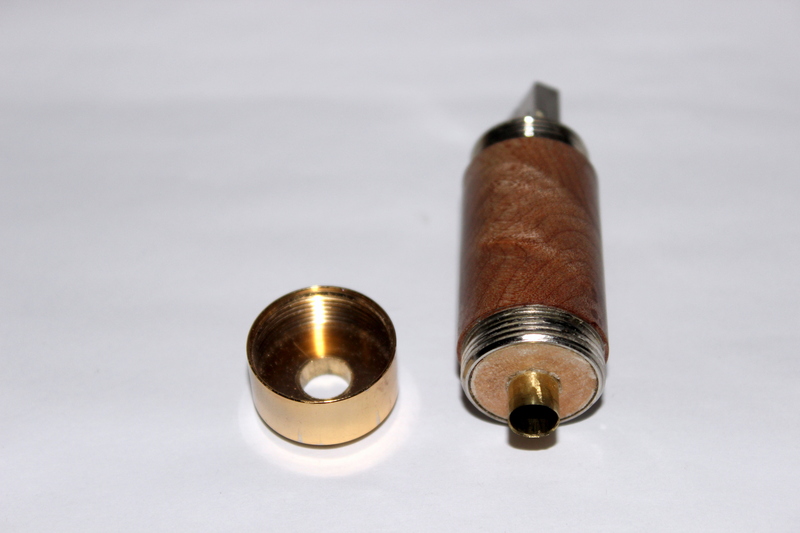

Drilled out the key chain attachment in the top cap, filled the hole with a finial from a slim line. Finial had to be shortened to clear the USB drive.

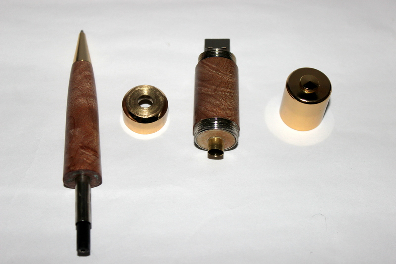

Here is the pen disassembled.

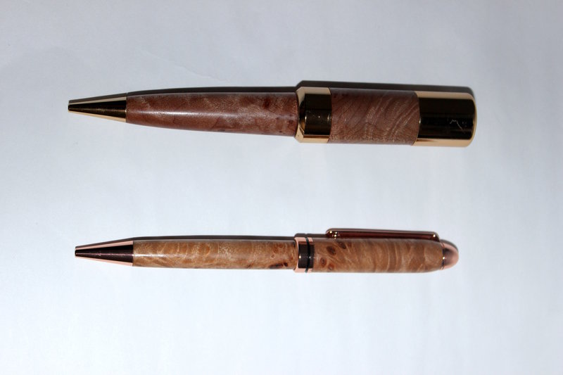

And the finished pen next to a standard Euro.
The pen is large and heavy but since the balance point rests right at the base of my thumb it is surprisingly comfortable to hold and write with.
