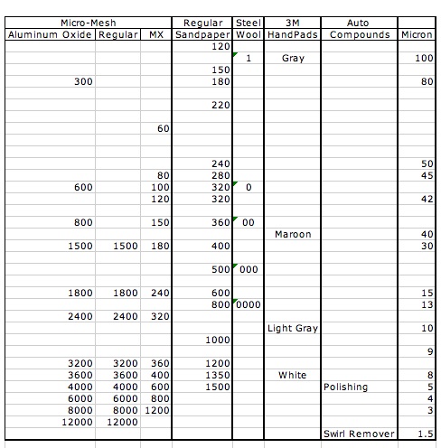

I find most charts of this type too complex to be useful. After a thread on Penturner's Paradise I compiled a chart for all the abrasives I use to sand and finish pen barrels. The data was gleaned from several charts available on the web and from this forum. If there are any errors please let me know and I'll correct the PDF file. However most of the data agrees with my experiences. I did find that I was overlapping (even going backwards a little) when I was switching from wet/dry to MM papers so the exercise saved me a few steps. Most interesting is where the Beall compounds fit into the overall scheme. Hope you find this useful.

Thanks for this Larry. You've answered some questions I've had, like where white diamond sits in relation to MM grades.

Thanks Manny, I've added this info to the PDF file. The Novus 2 didn't specify which system they use so I used the ANSI standard mesh size for 1200 grit, this may or may not be right.

I did one a while ago. Here it is again.
Between the two I think we covered most everything.
Someone asked about the green buffing material. The problem I found is that there are several different "green" and "red" and "white" compounds and each is different. There is no way to say that "color-XX" is this micron.
