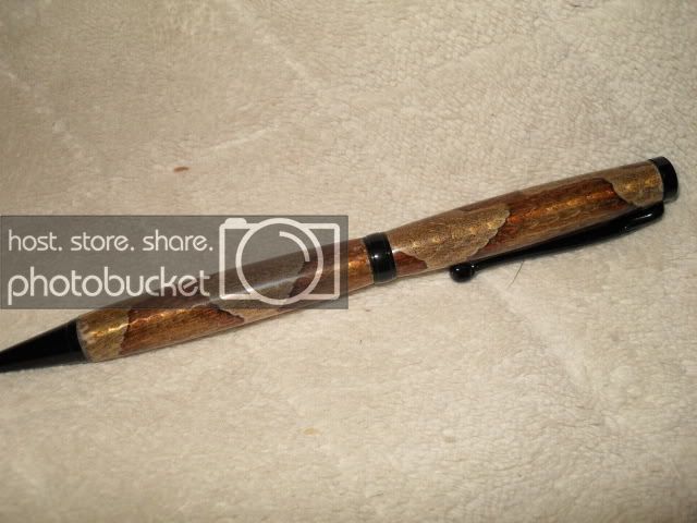

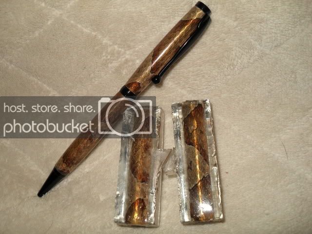

well I have dispelled the rumor of not being able to use untanned snakeskins folks!
just make sure they are thin! like paper thin, and that seems to work great

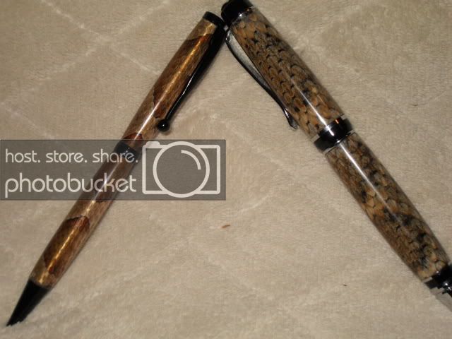

the rattler was tanned, the copperhead slim wasn't
enjoy
next to 2 sierra blanks

they will not decay they were skinned, scraped and dried before i glued them up, the guy i got them from probably had them lying around for a year or more.
but man that would be gross lol
i know plenty of guys who have these in abundance because they use them for backing bows(traditional/primitive archery)
the ones i cannot save for a bow (too small) get put on pens:biggrin:

The pens look great and you did a really nice job casting. Good work!
