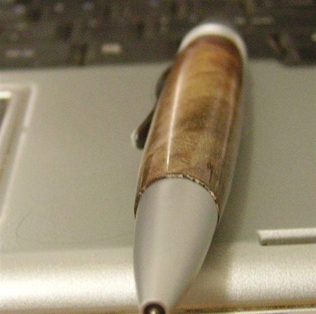

Hi When I am turning a pen, I am noticing the pens have all these divets out of it. I was blaming the tools but now when I look down the barrel near the tube it also turning one side down a lot more than the other. The pens are like overhanging the fittings on one side. the really dinged up blank is the one nearest to the tailstock...What is the cause of this and how do i fix it?

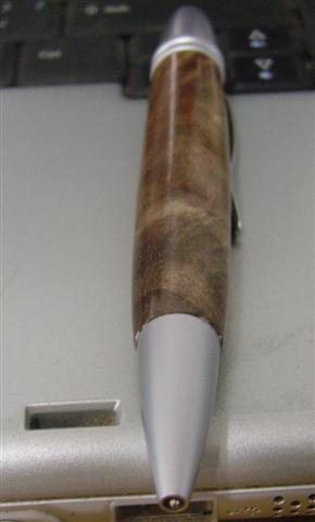

[:(]I spent all last night cleaning her morse they are clean. Well I can't feel or see nothing in it. I tried swapping the blank..Well now I have blank both chipped out on each end. Like the last 3rd of the pen nearest to the head stock have chipped out on my last 6 pens. I bought a new mandrel because my last one I gave a bad time it even had hunks ground out of it.[:I] but still problems. The only other turner I know is my father in law and his lathe knowledge is exact same as mine we started nearly together.[:(] I thought it could be my drive because it was pretty dinged up. so I tryed another one. I am definitely gluing them up enough because you can see on the blow off pieces that I am regluing back on where the glue been. see the photo I have added one side is on the bottom is flush the top one is out.
Any other suggestions??
