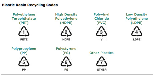

I don't know which "cheap" plastic cups anyone is buying but if they don't have the recycling codes 1(PET), 2(HDPE) or 5(PP) then you shouldn't be taking a chance with them anyway. Polyester resin will disolve all of the other cheap plastic cups that are not a RC 1, 2 or 5.
Cheap plastic ones work just fine for Epoxy resin.
Just when you have both epoxy and PR (and alumilite) you have to be careful to be sure you grab the right kind of cup.
Maybe I should add that Recycling code to my notes

I discovered something this week. RC6 cups somehow contribute to the demold stickiness. I was using the last of my plastic cups and at the same time I used a waxwd paper cup for a different color. The cast mixed in the paper cup had no stickiness. The cast mixed in the plastic was typically sticky.
I have no idea why this would be, and a single event does not a trend make, but it would explain much.
RC 6 is polystyrene. Polystyrene is disolved by the styrene solvent in polyester resin. So you are changing/contaminating your resin with the plastic from the cup.
