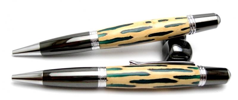

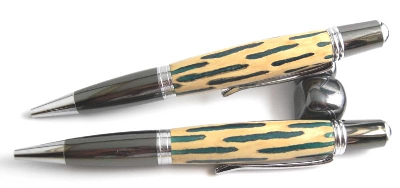

I have had request for 6 Cholla Skeleton Pens Here is two of them in Green Alumilite with white pearl powder on Black ti sierras. They have a CA finish that has been sanded to 1500 then MM to 4000 and Plastix polished, inside of the blank was painted white.
Any Comments welcome, Thank you for looking. :smile:

Man they look terrible. You should send them to me. :biggrin::biggrin::biggrin::biggrin::biggrin::biggrin::biggrin::biggrin::biggrin::biggrin:
Seriously, they look really nice. I have two pieces of Chola to fill and play with. I can't wait.
Very nice, it's hard to believe how much better the pics on the left look than on the right. Just goes to show how important good pictures are.
Thanks.
Mine show up as top and bottom, but the one on the left (top) that you are talking about was shot with the light on the top of the tent. The other one was shot with the light from the side, I was trying to reduce some of the glare in the second shot. These are the best of the two groups. :smile:
