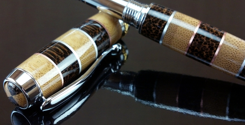

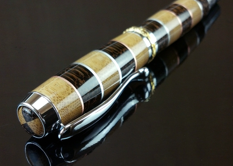

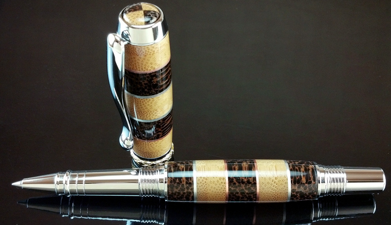

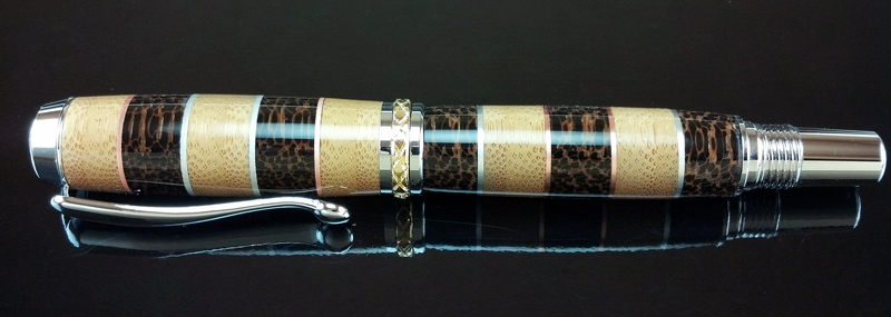

No, I didn't know black palm and bamboo were monocots until I looked it up. I have always found the end grains of these two woods to have a striking appearance so I decided to make a pen with end grain showing. What a tough pen to make. The black palm has hard and soft wood and the bamboo isn't much different. Now flip them to the grain side and try to turn that. I had plenty of issues with flying pieces of wood. There were many come-aparts! I had at least one and the blanks had five or so. Eventually, using the combination of really sharp tools and doing some power sanding, I was able to get the blanks down to size and shape. In between the wood is brass and aluminum. I don't believe I will be making an end grain pen again. I like the results but it took about three days considering the re-builds and come-aparts.

Thanks for the comments.
Mike,
You said brass and aluminum, but it looks like copper and aluminum... brain fart?
Dan,
I went to the shop to see what was on the package. No package to find. I get my metal from hobby lobby. I think it is brass based on the yellowish color of what is in the shop. I don't recall buying copper from hobby lobby but they carry both. Bottom line, I'm going with brass but I can't prove it.
Wow, that looks fantastic! I may have to try that...
Good luck. :smile: I would recommend smoothing the edges with rough sandpaper first or maybe band sawing off the corners first. I did not do that at first and I paid for it.

That could be one of the nicest pens I've seen...and on this site that's saying something..the third pic I can't quit going back to and going holy crap that pen is beautiful:eek::biggrin:
