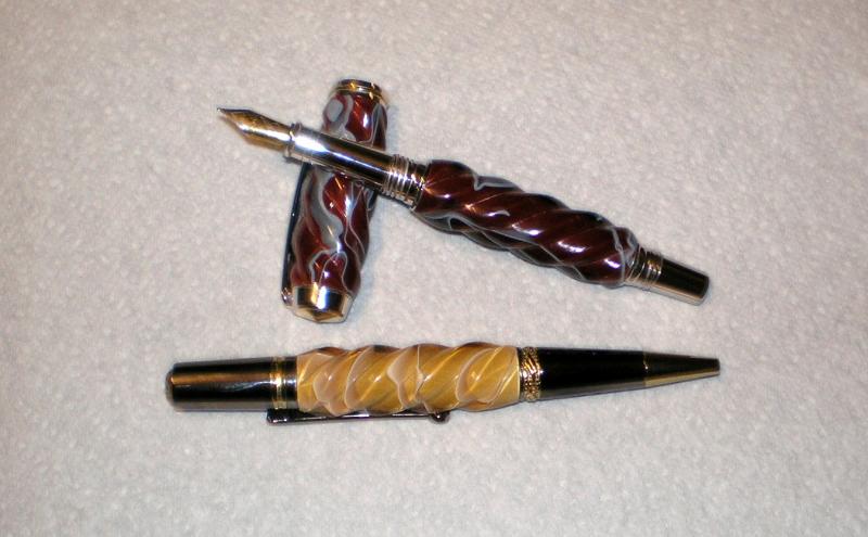

I did a couple pens with the rope twist. With the lucite blanks, I have always powder coated the tubes black and painted the inside of the tubes black also. I have always been happy with the end results. This time I thought why not try and brighten thing up a bit. The Majestic Squire is Italian lucite from Exotic Blanks in the root beer float color with the tube powder coated yellow, inside of blank painted yellow, and some of the yellow powder coat powder mixed with epoxy when I glued the tubes in. The amber color of the lucite darkened the yellow a lot, but I still like it. The Jr. Gent. has a piece of Italian lucite that I have had on the back of a shelf for several years. It is a very dark smoke color, almost black with the white swirls. I powder coated the tubes candy apple red, painted the inside of the blank cherry red, and mixed some of the powder coat powder with the epoxy when I glued the tubes in. I really like this one. I know several of you are going to ask how I got the twist design. I filed grooves the length of the blank, heated in the toaster oven until the blank got soft, then carefully twisted the blanks until I got the desired look. :-) OK, not really, I used the legacy Revo.
Forgive my lack of photo skills, I just have a point and shoot and it shows.
All comments welcome and appreciated. Thank you for looking.

Gary...you had me going for a while about the toaster.
Nice work...I especially like how the color of the red lucite ended up
I believe the toaster thing. I am pretty sure he did do it that way and is just trying to throw the rest of us off.
Gary, you have two very beautiful pens there. They will make someone very happy to spend some money with you. Congratulations.
Charles
Really great work! I recently purchased some of the same lucite (Rootbeer) and this helps with the understanding of how I need to set up for prep. Again, awesome looking pens!
I want to add that with this lucite I drilled the first hole just undersized and then used another drill that measured with my calipers about .020 larger than the tube to finish the hole. The purpose of the two steps is the second drill having so little material to remove leaves a smoother hole. Just go easy and not slam the drill through in a hurry or you will still get heavy lines. Also by going a little larger leaves more room for the epoxy and is less likely to pull the paint. I also use a dremal with a polishing cylinder and polishing compound to polish the inside of the hole. This type of lucite is so transparent in places that any line will show and not look good in my opinion.
