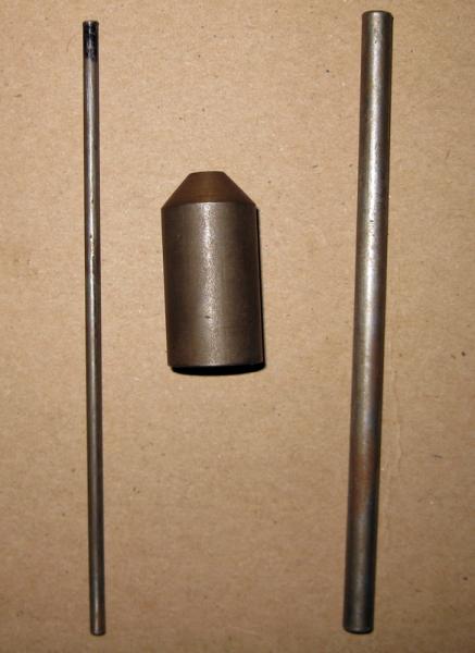

here is what I use. Ignore the picture quality and the shape the tools are in I have not used them in years.
the one on the left is used to tap the nib off. it goes through the transmission.
The big on in the middle then fits over the transmission to protect it. The one on the right goes through the nib end to tap the transmission out. I used the lathe as a "press to push it through. I would put the big piece against the headstock and put the tail-stock against the 3rd one. Then lock it down and turn the tail-stock slowly. Worked great.
I don't remember where I got it this disassemble set from. But the punches you will hear talked about come from harbor freight.
