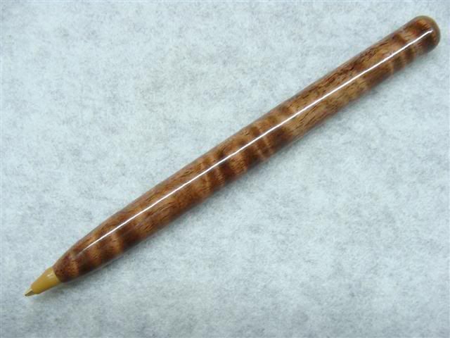

An ongoing discussion in another site about these 12 cent Bic kit pens inspired me to try one using others ideas as well as my own.
Here is my response after reading different suggestions on making them.
Well, y'all just knew I had to try it didn't you :D
First job back in my shop after the cut hand so decided to try something simple like this . Did it a little different than other ways I have seen it done so far but it worked out OK. Only one drill size was used in the making of it . I have a bunch of other stuff to catch up on for now but when I make the next ones (and there will be more) I will make up a tutorial or video to show my little slant on making them .
I didn't go into any fancy shapes or burn rings or such on this one because it was a nice piece of figured walnut and I didn't want to distract from that. .
These are a nice 12 cent pen to give away in areas like mine where pens made from expensive kits don't sell.
It is a good incentive when people are looking at bowls or pepper mills or any of a number of other turnings to mention that I will give one of those no charge with any purchase over $30.00..
Finish is 4 applications of BLO/CA applied in 20 second intervals .
Total overall length is exactly five inches.
Sorry for the poor picture. I only do point and click photography in automatic mode with my camera.
Like the wood all the way down to the nib....sorry, you lost me there.
Closed end is truly wonderful, and the wood you used would have made for a nice twist slimline(or even better) real pen.

It is a Bic refil .
Just pull the refill out of the wood pen and replace it with another 12 cent Bic refil if it ever runs dry.
Comes out of the wood pen the same way it comes out of the plastic Bic housing.

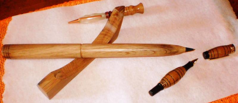

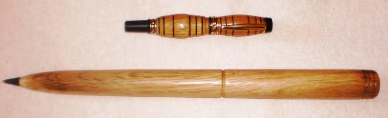

I just tried one yesterday and didn't have a Bic handy, so I used a Paper Mate refill instead.
I made the pen somewhat oversize just to have a conversation piece and used Oak for the wood. I will try and create some more in a standard size now that I have completed a first one.

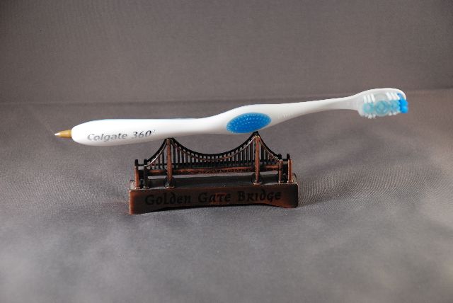

I used the cheap bic pens a few times. If you don't want to drill for the full length of the refill just cut it to length. I also found out that a vent hole is needed sometimes. I have made a lot of pens out of tooth brushes for my wife. She's a dental sales rep.

Very clever pen and nicely done. I have never seen this pen. Do you post your work here much??? Love to see what else you have done. Thanks for showing.

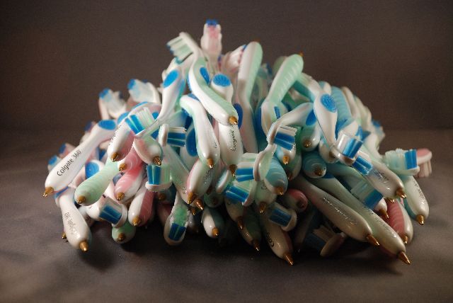

I've made probably a few hundred of these pens as give away for my wife and a few other of her sales rep friends. I just do it for fun. Here is a picture of the last lot of them I did.

Awesome idea with the tooth brushes. They look real nice.
