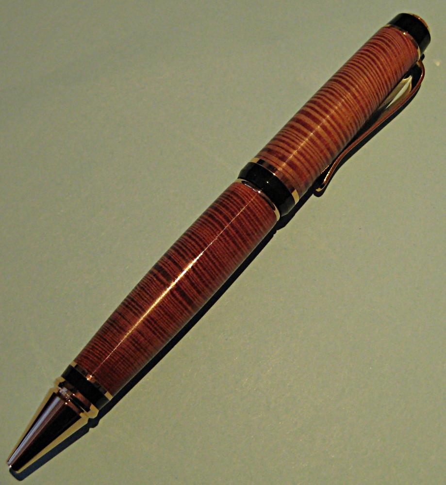

I know it can be done! :D 75-100 year old crosscut Antique Heart Pine with a BLO/CA finish.

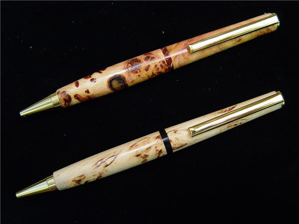

More proof that Pine makes bad pens. These are fat SlimLines made from Pine that I find in the racks at Lowe's and HomeDepot.
