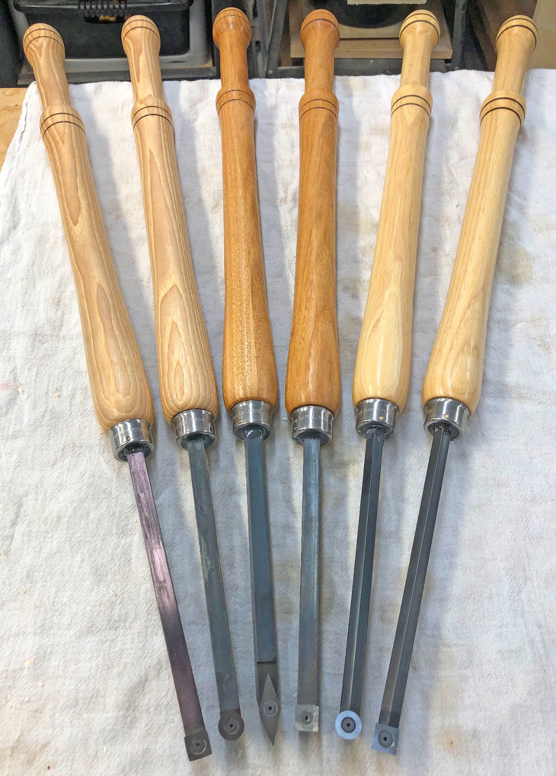

Here is a picture of a few that I have made. (Sometimes I think making tools is just about as much fun as making pens). - Dave

My screws were all 4-40 - the same as the ones used in the few Easy Wood Tools that I patterned mine with. Instead of trying to drill them, to make things easier for me, before I glued them together, I made a dado in both halves of the handles to provide a slot for the square (or hexagonal) stock. I also glued some 38 caliber bullets (bullets, not entire cartridges) in the back of my handles as I prefer a little more weight at the back end. I used Pex Stainless Steel Crimp Sleeves for ferrules because I like their shape - with one end flared out and the other end turned in I think they really added to the look. And, finally, I used some paint-on gun bluing on the square stock to darken it. - Dave

I'm in a similar boat. One of the departments I managed was a machine shop, but I haven't gone back to them for any "special projects" since I retired -- it's been very tempting though! I did most of my shaping with a 1" belt sander. - Dave
