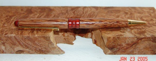

I got two blanks in an assortment pack. Sharpen, then sharpen again. Tear out sucks but the grain in quite interesting. I am working on a modified slimline with a paduk center band. It is sitting next to me on the mandrel with the finish curing. I will post a pick when I can.

I just posted this in another place but this is my recent palm pen. It is red palm, paduk details, slimline kit, friction finish.
