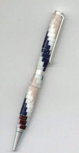

I have done a couple of corian pens. This was the first one.
<br />
The only tools I used were a roughing gouge, till I got near the final shape, than I switched to a skew. It deffinately took a bit longer than wood, but it weren't bad.
I know most of the joints could be tighter, and the photo stinks, but hey, I was a rookie back than. If I had more ambition, I'd try it again.
Good luck with your corian.
