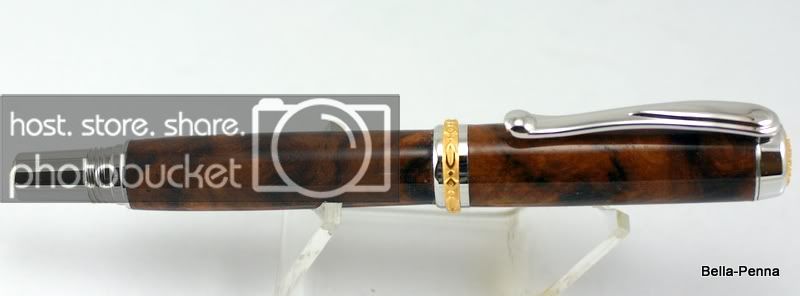

I have also made about 10 chestnut pens - I used R. Fairfield method with wet sealing of the wood (medium Ca and 180 sandpaper). Works great and can be seen in the librabry.
I've got 2 more blanks of this American Chestnut Burl. Think next ones will have a gloss finish:
