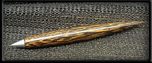

i love this wood, its very decorativ. I cut this with sharp skews ( is this the correct word?) sometimes i beginn sanding with the 100 paper,CA helps too.And you may have a little patience.
here is one of my Flippers in Black Palmira
i fear, i have a problem with the technical terms in English.

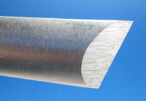

I cut the Palmira with this tool:
That should work just fine, and oval skew too, very nice! Keep it sharp, maybe use a diamond hone one or twice while you turn the pen, keep it sharp. Some thin CA to "lock it togather" would be nice when you get close to being done as well.
