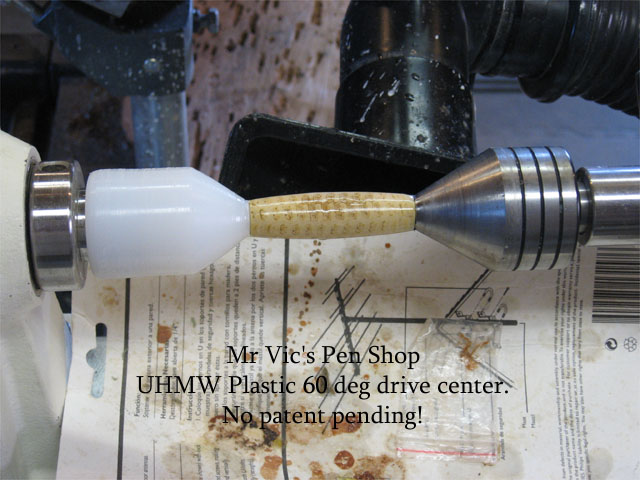

I turn my blanks with bushings and mandrel till Im near the diameter. Then I'll dismount and finish w/o bushings between centers. I use a micrometer to determine correct diameterr for the fittings I'm using. I don't use a metal dead center. I tapped a block of UHMW plastic which screws onto the drive spindle. With a skew I turned it down to 60deg. I like it because it has some give which reduces the chance of tube flaring. If it gets gunked up I just turn it down a bit more.

Mr Vic, I kind of thought of something like that, but don't have a way to tap it for the spindle, I was thinking maybe I'd used my chuck to hold it instead. I'll be doing some experimenting and let you all know what I end up doing. Thanks again.
