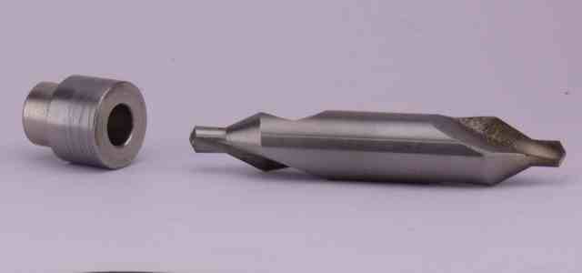

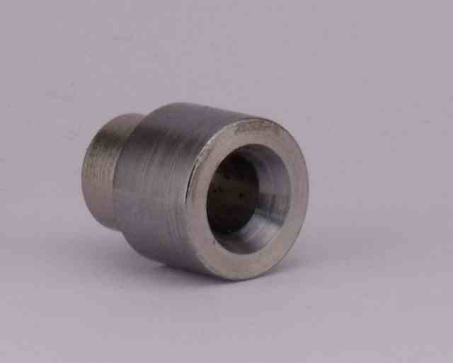

Sure you can, but you can make them seat better in the centres, by centre drilling the ends. If you do this, they will be more accurate and you will need less tailstock pressure.

Yes, you can use them. The results may not be as good as with TBC bushings. There are several ways to do it:
1 - Just put the centers into the holes as they are. Quick and easy, but the least accurate way to do it.
2 - stick slimline TBC bushings in the regular bushing holes. Better than the first way, but your accuracy is only as good as the bushings.
3 - Use a drill center to put a 60-degree chamfer in the holes. This gives you a taper to fit the live/dead centers for more grip and better self-centering. Don't trust the wide part of the bushing to be round or centered - chuck to the part that goes into the tube, and use the most accurate chuck you have. It's conceivable this could even compensate for an off-center hole!
I started out doing (1). I'm gradually replacing my bushings with TBC bushings, but for any I haven't replaced yet, I use (2) with decent results. I also use the slimline bushings and calipers for all 7mm tube kits.

That short drill is called a centre drill. You can buy them individually or in sets. I drilled that bushing on a lathe a while ago just to show the concept.
