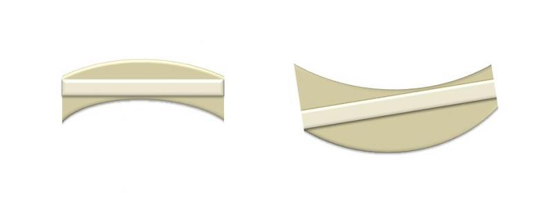

When I am trying to get some of the original left on the pen after turning I will drill a piece across a curve in the antler. That way you do not have to leave the center unturned and you can still get the shape you want.
Here is an example in a slimline
The lower blank was drilled across a curve in the antler leaving a piece of the "bark" showing when the pen is turned down to a standard profile.

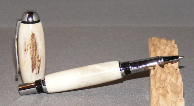

You can also get a nice look by using a larger diameter and turning down closer to the marrow and filling with CA glue giving a nice graining pattern like this:

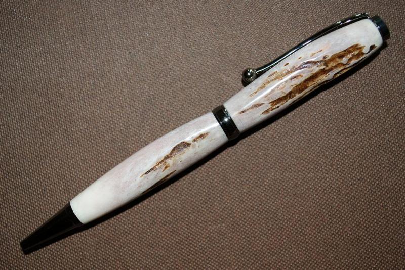

did one last night with a piece of Axis Antler. Turner on barrel like always but the cap barrel I turned very fat so that it left a bit of bark. It looks pretty good and with the Axis, there was no marrow to speak of. I'll be takign pics tonight
quick shot of the pen.

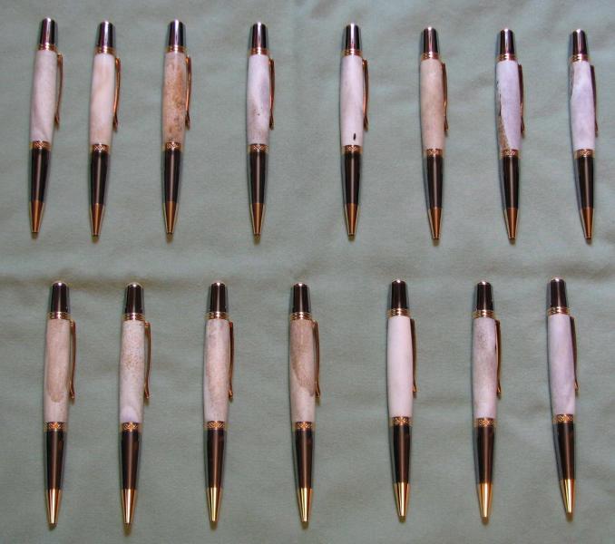

From what I've seen, antler color varies a lot. It may even be somewhat at random. I turned fifteen whitetail Sierras last year using one complete set of antlers and a third single antler. The first photo here shows the variety I encountered. Sometimes the outer sheath has a dark appearance, sometimes not. Some marrow is also darker. It is worth some trial and error as (IMHO) there is no bad antler. If trying for bark, it may help to look at a post from jrc regarding drilling antler. It definitely provides an increased level of control.
http://www.penturners.org/forum/showthread.php?t=42550&highlight=drilling+antler
Finally, the marrow from an elk antler (second photo) can be really dark (though very porous and requiring lots of CA to fill). In my experience with antler, elk contains some of the darkest marrow going.

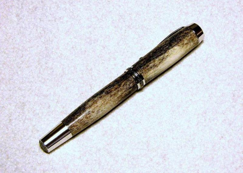

Not all antler will provide you will the natural surface you want. It needs to be thin enough so you dont have to turn it all down, and you need antler with a nice deep texture. I like to use younger deer antler and usually the bur, or area closest to the head, is what you want. I usually try to mix them up with a low piece and a higher tine piece so you get a couple pens with upper barrel texture from one rack. As others have said, you can also drill off center if you dont have a piece with lots of marrow, and drilling on the curve works well too, if you can do it without blowing out the side. Its mostly hit and miss but there are some tips to help you get closer to what you want. Good Luck!

I pick out pieces of antler with a curve in them so I can drill them like this. I usually go for exposed bark in the middle of the tube section, if the bark is exposed on the ends it doesn't match up very well with the nib, cap and center band.
