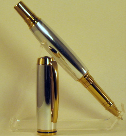

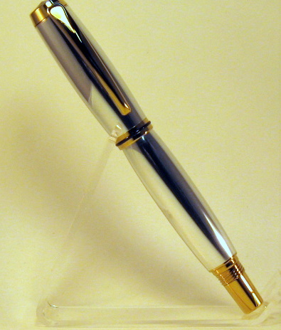

Rick, just FYI, johnnycnc has aluminum blanks already drilled, cut to length and champ-ford for certain kits. Here's one I made with some of them. In case you'd be interested in saving a few steps in the future.
Hope to see your pen when it's done.
