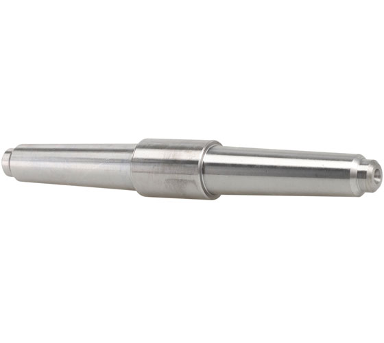

Might be of interest to you.
Alignment tool
