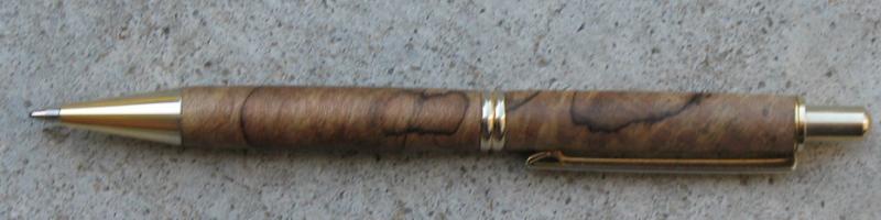

I believe Charlie is right. Pure tung oil takes days to dry, however it does leave a very soft and natural wood finish. I'm new to pen turning but have been finishing wood for 45 years. No one finish is the one and only finish however, I am learning the CA process. Haven't conquered it just yet.
Pure Tung oil will have no additives! If you see additive you are probably using a wiping or oil varnish mix, which may or may not contain Tung oil. That is okay too just follow direction information on container for application.
Using pure Tung oil, light coats, let dry and sand between applications. It takes six or more coats to get a satin finish that is waterproof and stops exchange of water vapor. Do not try rushing the process. Too heavy coating can turn white. Only way to fix that is sand down and reapply thin coats of Tung oil.
Why use pure Tung oil finish? Like Shellac, Tung oil is a Green," finish. Is it okay to sell pens with either Shellac or Tung oil finish? Sure why not, people buying that pen comfortable with look and feel of the pen! No, neither Shellac nor Tung oil considered a durable finish.
I use a click pen finished with Crystal Coat daily no longer shinny. I like the wood feel, been using it for more than five years. The finish is on the pen may be lacking, but no dirt, grime, or scratches on the wood.
