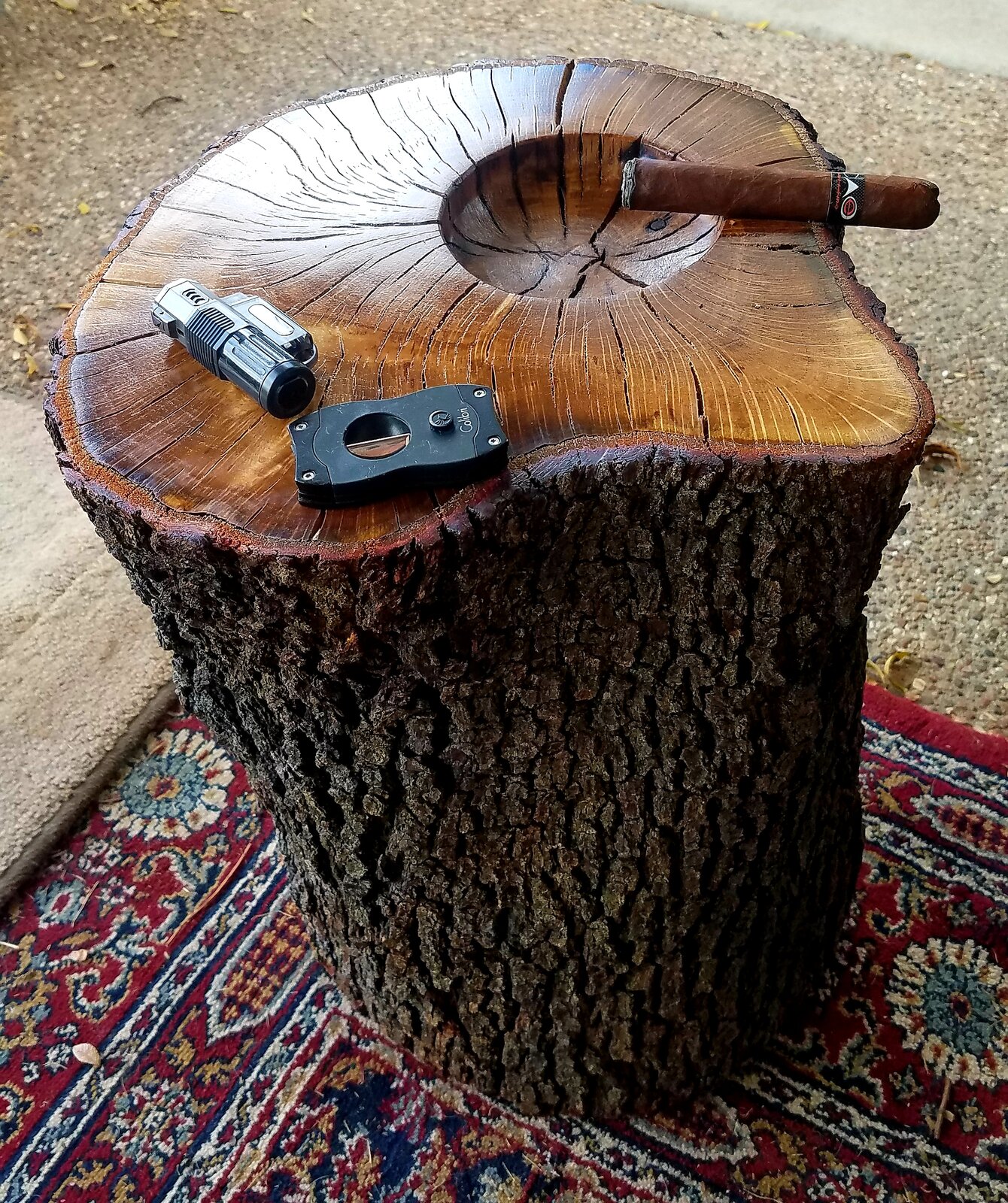

So I picked this log while helping a friend clear out his back 40. It's an outside piece. I treated it with Tung oil and sprayed a coat of polyurethane over it. Has anyone tried Tung oil on their pens?

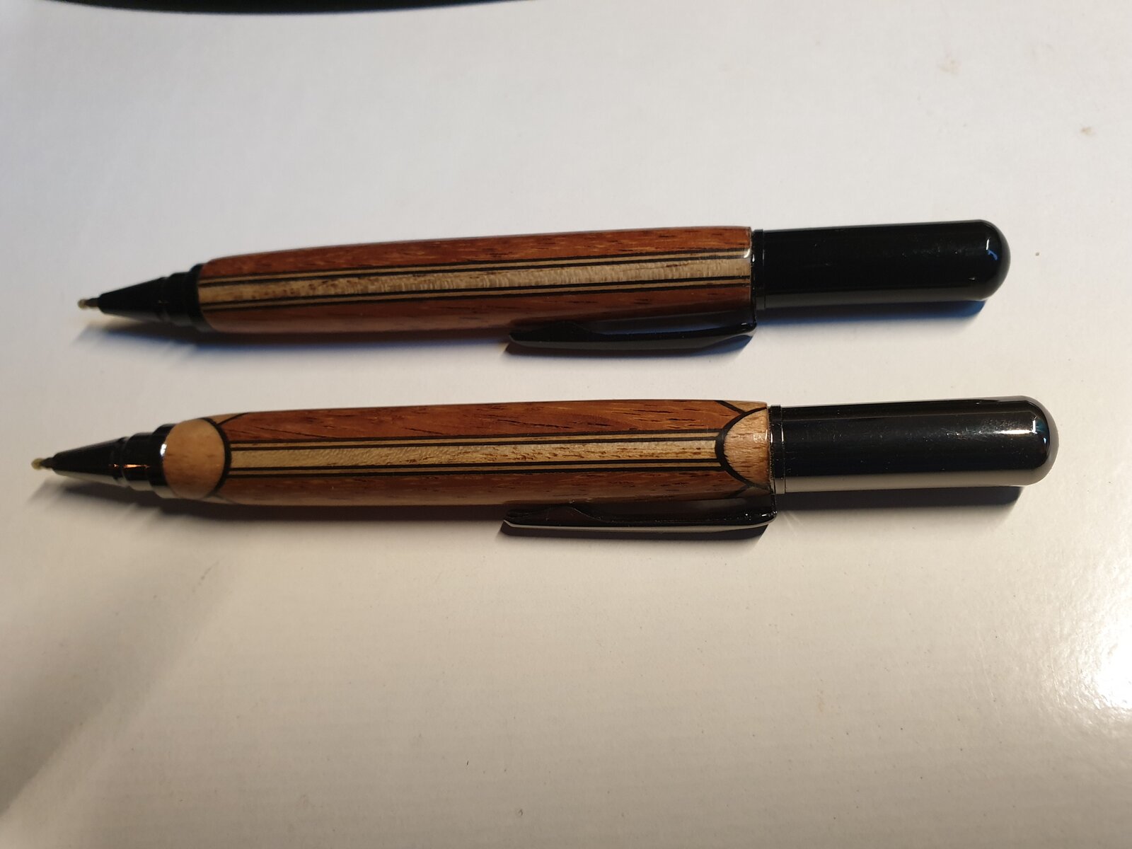

Hello Cynot,
There is a article on boiled linseed oil in combination with CA glue.
I have a can of danish oil, >90% tung oil, and i tried it a few times on on a pen.
It works well.
Peter
