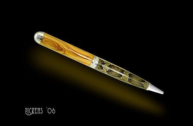

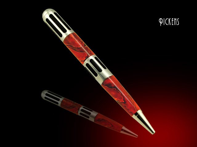

I was paging through some of the newer photos and was surprised to find a couple of pictures of pens created by my "big brother." These are too nice not to be shared, so like any "little brother" I decided to post them. These are highly modified slimlines...he only uses the 7mm tubes and the Cross-type transmissions. All of the rest is handcrafted. Hopefully Jay Pickens will chime in and give us some details.
Hey Lou, thanks for sharing that with us. I did see the snakeskin one as the feature photo just recently, but I never appreciated that they were modded slimlines. I thought they were another fancy kit you guys get ( that we can't ) The red acrylic is awesome, and I think I prefer that one. I just had a quick look to see some more of Jay's pics, but can't seem to find them. What is his 'handle'
I think I've just found my next source of 'inspiration'[:D]
Thanks
Jay even cast the red acrylic! His screenname on this site is jpick22 but the best place to see more of his work is at http://www.penmakersguild.com/browse.php?gallery=pickensj&page=0 ... or you can visit a few of his fine creations at my house! [8D]

FIRST, THANK YOU LOU FOR POSTING THESE PICS. NOW WE CLEARLY KNOW WHERE THE "BRAINS" IN THE FAMILY WENT. I STILL HAVEN'T FIGURED OUT HOW TO POST PICS ALONG WITH A TOPIC MESSAGE???
SECONDLY, the red pen was a blank I purchased (as have many others of our pen-making family ) from CSUSA (I think!). One of the most beautiful that they offer - I wish I COULD make a blank like that!!!

Thanks Lou to showing those pens, Beautiful Jay, I do have a question, on your second pen the snake and olive wood ( I presume ) did you use a ring for the CB ? or did you engraved one with your power tool. Thanks
Morning Serge -
The centerand was nothing more than aluminum tubing (1/2" outer diameter). The design was nothing more than a small (can't remember actual diameter) "ball-end" end-mill cutter. It was done using a small milling machine, but I see no reason why the "dimpled band" look, couldn't be achieved using the same type cutter in a drill press - then, a final buffing.
A person doing this with a drill press would have to come up with a jig that could be turned a specific angle for each "dimpling" and then advanced to the next position, etc., etc., etc. Like using a chuck(for the tubing piece, placed into a Rotary Table).
