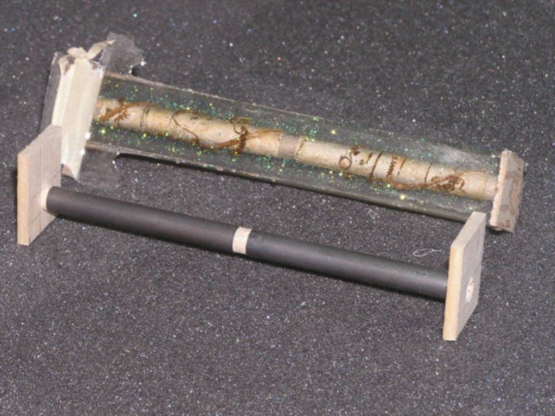

Here is a picture of the PR plugs I've been dealing with.
I was also thinking I could just put these back in the tubes before I cast. I just don't know...

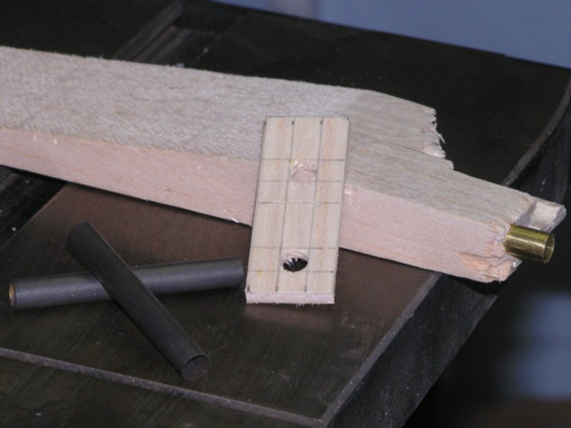

I was wondering what do you guys use to support your tubes to stay centered in the mold.
This what I do I use balsa. I got a lot from my modeling days. I take a large soft piece. take a pen tube sharpen the end push it into the balsa then just push the balsa out with a mandrel. Whala a perfect balsa dowel. Then I med. CA it in the tube. Then to support the ends I cut sheet balsa to fit the mold then use a tube to punch out a hole and CA the whole thing together. I seldom get a leak and it is usually easy to clean out. And I cast at 50psi.
Just wanted to share what I do and perhaps find a better way.
I also started a new thread so outher could see and relpy to this.
