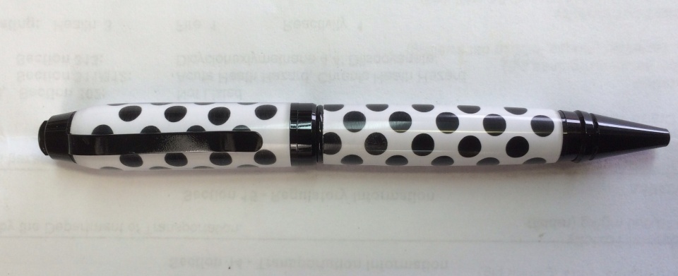

Granted I haven't tried this with acrylics because my experience is with casting painted tubes.
