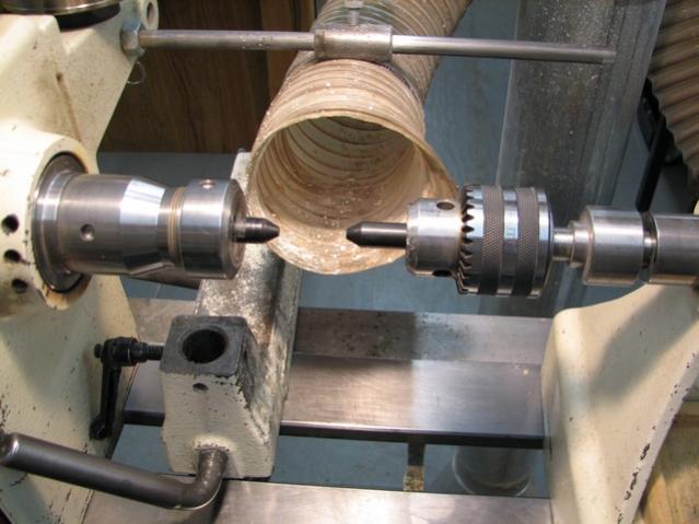

Hank, I really don't have an answer to your question as to EXACTLY how flaring occurs but I do think I "might" have a remedy for it. I make my own centers from Delrin. I put one in my Beall chuck at the headstock and one in a "revolving" drill chuck in the tailstock. I use this set-up for sanding and applying CA after removing the blank from the bushings. The Delrin seems to grip better than metal with less pressure. While I can't say "for sure" that this prevents flaring, I can say that it has never been a problem for me.
Here's a photo, they always help.:wink:

Hank, one more thing to think about. I was removing wood from some old tubes and decided to try different methods. My Delrin centers helped "a little" but by far the best results were when I took LIGHT cuts. Normal pressure caused flaring and light pressure didn't. Something else to think about.:wink::biggrin:
