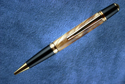

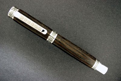

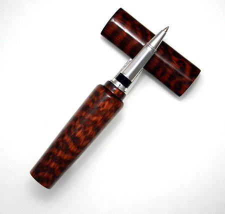

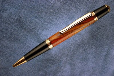

Examples of TSW on open pored and/or unfinished woods:
<br />
Bethlehem olivewood - no finish +TSW

Cocobolo - Lacquer +TSW
<br />
Irish Bog Oak - Lacquer +TSW
<br />
Snakewood - No finish +TSW

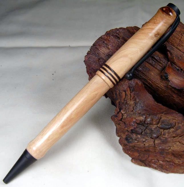

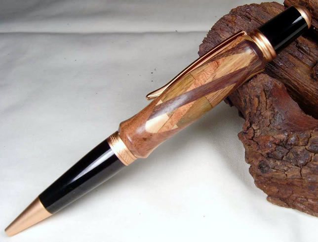

Okay, I'm not Lou, and he has sufficiently addresses this, but here's my spin on this. I use TSW on bare wood frequently (almost always on most oily woods in fact). Yes, it takes time and repeated steps to seal the open grain of woods like Coco, but I believe it is worth the wait and effort. My rule of thumb is that I can still see dips in the grain that are more than a few thousandths of an inch deep (takes some trial and plenty of error to figure out what that is), I keep applying sealer and sanding off the surface coat (MM only and always). Here are three examples.
Glue-up of Olive, Lignum Vitae, Cocobolo, Texas Ebony and Mesquite.

Pecan
<br />
