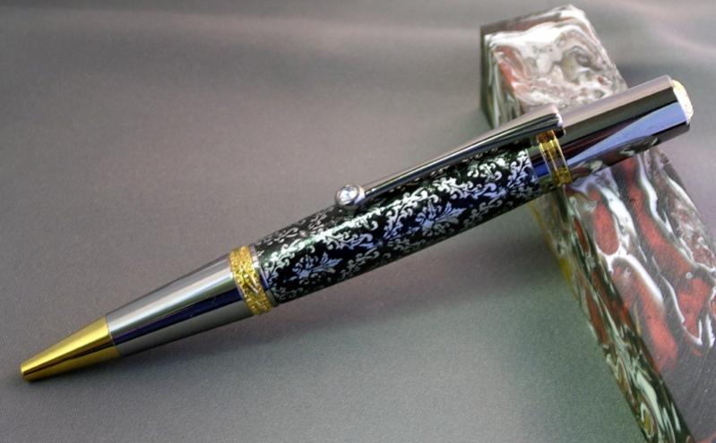

Been dying to try this out for a while now, but couldn't find shop time.
I don't think I'll try it again.. took 2 hours to laser!
6063 Aluminum with ceramic marker. Creative Dimensions blank
called Renaissance. Ok, I tried it .. now I'm over it. :tongue:

I was hoping to try it in anodized aluminum, but my anodizing skills are ..
... um .. sub par. So I was hoping that with a highly polished aluminum
blank and a ceramic marking spray I'd get the high contrast I wanted.
This is the closest I got, after sanding off the marker several times. (you
can see that the bottom is over-sanded by now)
I might try it one more time, oversanding again and then casting in clear.
That way I could build up a clear coating to protect the ceramic marker.
Might need to try a different marking spray, too .. but they get almost
$100 for one of those 12 ounce spray cans! :eek: (with shipping)
I was hoping to make these available, but for that 2 hours the laser can't
be unattended, and I can't use any other equipment because of the
power fluctuations. Watching the laser beam with your remaining eye is
only interesting for the first few minutes. So they're not commercially
viable.

It takes a few tries with each new metal (and thickness of metal) to get the laser settings dialed in for a successful Cermark (or Thermark). It looks like you managed to get a very nice mark in the end, though.
Stainless steel marks much more easily than aluminum, and brushed aluminum easier than polished aluminum. If you really want a challenge, try brass. The mark will hold up better (and show higher contrast) if you clear-coat it afterwards.
If you can find the high-tack Cermark in a 12-oz spray can, please let me know where. My regular source only has it in 250g paste that must be thinned before spraying. Also, it's classified as a "hazardous material", so that adds an extra $25.00 to the cost.
I'll take the paste over the spray can, considering that the can stops
spraying after about 1/10th of a can is used.. :eek: With the paste, I can
mix it with DNA and spray with an airbrush. No hazmat charges. But a 250g
jar must still be close to $150 or so. ouch.
Clear coat is needed, yes. I used some lacquer just to get the photo. But
the Cermark will come right off. 30W, 100% power and .5 speed.
At 2% speed, it RINSED off :eek: at .5 I'll need to wipe. .but it isn't bonded.

It doesn't work well on aluminum. It does work fine on stainless and titanium. I run my 130 watt at 90% power and 100% speed. I use the can. I also dip the nozzle in my ultrasonic cleaner after each spray. Just soaking it in water is better than not doing anything.

The spray can must be kept well shaken, or else it tends to clog up. If you let it sit for a day or so, it will often start spraying again. I usually get about 3/4 of the way through a can before it starts misbehaving.
When using the paste, be sure to stir it up before mixing a batch with DNA. I'm told the pigment can settle out even in paste form. Also, I've found that airbrushing puts on a much thinner and wetter coat than the spray can. With brass, that can be a problem because it tarnishes the metal. It can take a few coats to equal the application thickness of the spray can. It's very important for the cermark coating to be fully dry before engraving (I let the piece sit for an hour after spraying).
The can is much more convenient, and is an ORM-D material (no hazmat charge). The paste is classified as a paint and does incur a hazmat fee (at least from laserbits).

What DPI are you using? I get much better results at 1000dpi. If your registration is repeatable, it also helps to engrave more than once. I have a 60W laser and have gotten a good, durable mark on solid aluminum at 75% power, 25% speed (with one pass).

ouch .. I don't even want to know how long it would take at 1000dpi!
Cermark says to run at 100% power and use your laser power as your speed.
(25W laser, use 25 speed.. 50 watt, use 50 speed etc.) but that hasn't
worked for me.
I stir, shake, thin with DNA and spray lightly. Just till I can't see the
reflection of the aluminum. They say that a thicker coating will inhibit
the laser's ability to reach the metal.
FWIW, I have both the spray and the paste, but they seem identical
except for the drying time.
If you double the dpi and double the speed, you should wind up with the same amount of laser time (twice as many lines, but each one is twice as fast). I get much better results - particularly for large black areas and horizontal lines - at 25% speed and 1000dpi than i get at 12% speed and 500dpi. For highly conductive metals (such as aluminum and especially brass), you need to generate a lot of heat. Higher dpi seems to do that better than slower speed.
Perhaps it's just my cheap airbrush, but when I thin the paste enough to flow well, I need 2 or 3 coats to equal the application thickness of the spray can.
Have you had any trouble with the heat spreading out to areas that you
don't want marked? I had some areas of fine detail that seemed to suck
in the heat from the laser pointing near/next to it. And since (so far) I'm
not getting a good bond, I can't scrub anything because it will come off
of the areas where I DO want it.
For instance, if I do lettering on a black background area, the entire block
turns black. Rinsing and washing with a paint brush will display SOME of
the lettering, but as the lettering gets clearer, the surrounding black area
starts to wash away, too. This means that .5 speed still is too fast for
the marker to 'take'. Had no trouble with steel, but tungsten, chrome
and aluminum are making me tear my hair out. But for this blank, I just
need it to stick long enough to cast in resin.

I dont' really have any way to make metal parts .. no tools or knowledge. But I did
try Skip's idea of doing the ceramic marking on a Jr. 2:02:30 PER TUBE!
(that's on top of the time to make the aluminum blank.)
gently washed them off, rinsed in DNA and gently put them in a ResinSaver and poured.
Even then, I think I wiped off some of the marker..
:confused::confused::confused::confused::confused::confused::confused::confused::confused:

LOL .. not all that new, but I haven't seen anyone doing it on pens yet.
I'm using the same pattern we use for some of the 3D blanks, but I'm
making aluminum pen blanks, spraying on a ceramic marker that turns
black and bonds to the metal when you hit it with a laser. and yeah, the
spray is outrageously expensive.
Can't sell these.. they'd be prohibitively expensive. $75 for the spray, a few
bucks for the aluminum, about two hours to cut, drill, turn and sand two
tubes, 4 hours to laser two tubes, overnight to cast in resin, then turn
the blanks, $20,000 for a decent laser .. :tongue:

I've noticed that effect when marking steel and compensate by making white areas a little larger. On brass, it hasn't been a problem for me so far. When I went from 300dpi to 500dpi, my image detail improved. Going from 500dpi to 1000dpi on brass, I got better adhesion and more solid blacks. The dpi made a difference when power and speed didn't.
It took me a lot of experimenting (and a lot of cermark) to get a good mark, but it is strong enough to withstand polishing. Text comes out durable enough to resist steel wool. On brass, ammonia-based polishes (such as Brasso) damage the mark, so I still powder-coat over it.

Yours is the first full wrap-around mark on an aluminum barrel that I've seen, but I have offered laser-marking (flat and rotary) on my bullet pen kits for a couple of years. The cost of the spray, the engraving time, and the fact that I have to do a special production run (to laser before powdercoating) lead me to price it at $10.00 and up.
