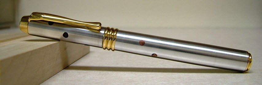

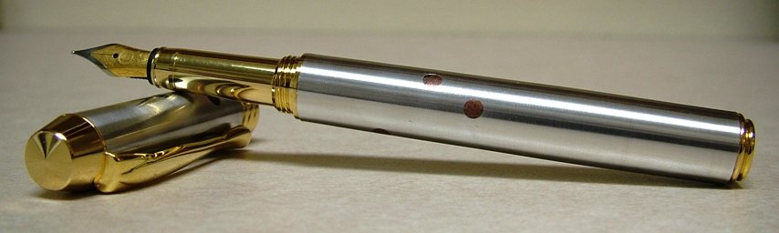

Here are pics of my first attempt with Aluminum. I've been wanting to do this for months and I've seen a lot of cool aluminum pens on the group here and thought I'd give it a go. I bought a 33" rod of 5/8" round aluminum from a local welding shop for $5. Being overly excited, I forgot to pick up the instructions and bushings (I pick my own orders here at Craft Supplies) but I felt like I could do it without those. I was half right [:I].
The kit calls for a 27/64" bit but I thought I'd try a 13/32" since I expected a little looseness in the hole. That turned out to be perfect. THE DRILLING WAS THE WORST PART! It took an hour and a half on my cheap benchtop drill press with a 2" stroke! The shavings clogged the channels of the drill bit easily and I had to keep a bowl of water close by to put the blank in after each little bit of drilling. My homemade pen blank vise was really struggling to hold onto the blank- it kept spinning. Next time I'll use the $40 Pen Blank Drilling Vise and I'll use a full size drill press. For decoration, I thought I'd drill some holes and use a copper filler. I acquired some copper dust and I mixed it with thick CA and filled the holes. Once that was done I glued in the tubes and barrel trimmed them. They trimmed really well- even better than most woods. I didn't have the right bushings so I took the smaller bushing from my Havana Ballpoint Bushing set and used those to mount it to the mandrel. I decided to use my adjustable mandrel to minimize the flex on the rod. I did them one at a time. I figured since it was metal I would turn it at the slowest speed (500 RPM) on my Jet mini. I tried the roughing gouge, the scraper and the spindle gouge and I found that the roughing gouge worked the best.
The inlay kept chipping out so I eventually used black CA glue on the cap section. It wasn't what I wanted to use but it was fine. I had already invested three and half hours into the pen at that point and I wanted to enjoy my Saturday night with my family so I left the shop. The next day my son and I went back out to the shop and I put the longer (bottom) tube on the mandrel. This time I thought I'd have better luck at a higher speed so I cranked it up to 4,000 RPM and wow- what a difference. Metal, plastic, wood- whatever- turn it fast! The copper inlay didn't chip out because I had it spinning fast enough and I plowed through the metal, producing long thin ribbons of 'tin foil'. I sanded to 600 grit to keep a bit of a Satin finish to it and I then put Renaissance Wax on it. It turned out OK for my first one but I need a few days to recover before I try another!
So what I learned was- turn fast, use a good drill press, think twice before trying decorative inlay on your first run and get some MicroMesh or higher grit paper if you want a highly reflective surface like chrome. I had fun and I'll try another before too long. Please feel free to make fun of my mismatched pen or complain about this long post. [:p]
Nils, that came out great! Nicely done all around. As you can tell from most of my posts, I tend to favor longer opening posts because it provides a better basis for anyone following in your footsteps, which is (IMHO) one of the great reasons for having this forum. I was especially interested in the speed issue; seems like what you struck on is a good rule of thumb. I guess I'll have to go home and dial up the speed (well, "belt up" the speed) on my TurnCrafter Pro!
Thanks for the info!
Oh, how often did you find yourself sharpening the tools?
Thanks for the commments. Jim- I sharpened every few minutes or so. Just turning the aluminum made the gouge extremely hot. I dipped the tool in the water bowl every few minutes as well. Aluminum really turns quite nicely, though (once you get the speed right).
Very nice Nils... that's a 10K Executive if my eyes are working right... I like that kit... it has sold well for me for people looking for a less expensive alternative in a RB or FP than the Jr Gent...
Please let us know more about the aluminum you turned.. what grade... I know that there are different hardness grades and that can definately affect the turning and finishing..
As Fred stated, I think you would have an easier time putting the blank into a set of 1" jaws and drilling and trimming on the lathe... in fact if you can find the right size drill, you might not even need the tubes. Just a thought from my somewhat feeble mind.. [;)]
Very nice Nils. We drill alum on the lathe. Our big lathe not mini. Works well for us. The advantage of having a full woodshop makes many of our chores easier.
Looks great. I am scared of the metals. I look at it as if I can screw up wood and shatter it into a million pieces, I dont want metal flying around my shop.
Someone asked for the best grade for our purposes, I recommend the 6061 and 6063 alloys. They both work well when machined. The aluminum one can buy at HD, Lowes or Sears Hardware is not good for maching, it smears and may color things dark. I have several Flattops and El Grande's in Al and about 14-16 Barons and Flattops in Titanium - here you talking about a tough material....
I have no idea what grade of aluminum it is. It was the only type available. I can't imagine turning Titanium or one of the harder metals. It sounds like I'll have to drill on the lathe next time. I've got everything I need to do it, I just need to try it next time.
Very nice, Nils. I agree with Rudy on the grades of aluminum. As a machinist, even in the shop, lessor grades are gummy to work with when machinied, and harder to get a good finish.
Very true Paul. Even with the harder grades like 6061 or 7075, the pen will easily get scratched when it contacts other metals. This is just something that will happen with any aluminum. It can also easily get oxidized with acidic fingers or other chemicals too. Fortunately, it's very easy to refinish and can be done to a nice brush finish anytime with a ScotchBrite pad, the green plastic scruffy pads normally used on pots and pans.
Bruce, can aluminum be easily plated with another metal, like gold, silver, or even a chrome finish?
Nils, one thing that might help protect the finish is to put a coat of poly or laquor (sp?) on there. Someone else can probably make a more definitive recommendation.
Nils, great looking pen! Actually I like the longer upper body and the smaller lower body. Personal preference, of course. I think it turned out great, considering it was your first time and helped ease your pain [:D] for the next one. Maybe not pain, but time for sure! Thanks for the blow-by-blow description. It helps those who haven't tried it fear it not!
Jim, the problem with plating aluminum is that it's relatively soft, so if it gets hit the underlying metal deforms and the coating can flake. It would take having it sent to a professional plater since the chemicals involved are very deadly. Anodizing is something else normally done to aluminum. This is a super hard oxide layer that gets dye impregnated in it. There are different types of anodizing including hard anodizing which could work OK. It loses the mirror finish though, and anodizers are likely to charge a high minimum order just like platers might. Lacquer can be done, but it scratches relatively easily.
Hmmmm...thanks Bruce! I'd like to take a shot at a metal pen, but I'd like to try something I can get plated when done. Not that Nils' pen doesn't look great like it is!
