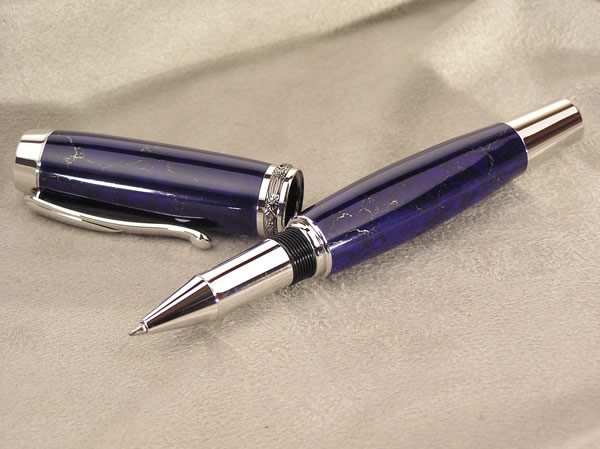

Here is a True Stone Lapis. I Got it at CSUSA. Nice finished product, though I was a little dissappointed in the lack of gold flecks that this blank had in it. Some are far better than others.
Fangar

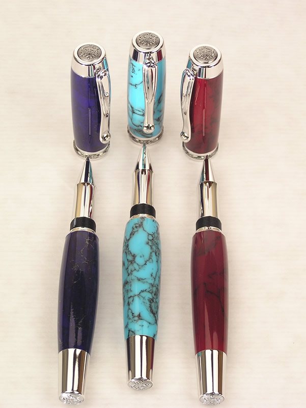

Ok, here they are.. no catastrophies. I agree that it is very hard to photograph the lapis properly. The Turquoise and Jasper were fairly easy to turn- they seemed almost celluloid-esque. However, the Lapis.. Hard as nails. Cut-Cut-Sharpen. I left my grinder running on this one. The Lapis, in person, is exquisite. I am going to attempt to get a better photo that highlights the gold a little more. Thanks for all the tips folks!
<br />
